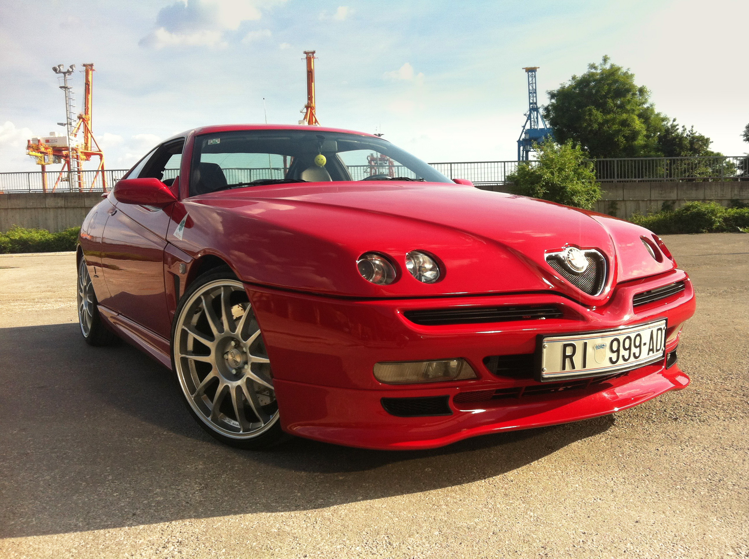

I have just found out that OZ Racing has revived the legendary Rally Racing wheel, but in 17, 18 and 19" size! :)
01_rally-racing-race-white-jpg-100x750-1
So I've made a simulation in 19" on mine... ok, ok, maybe it's too wild for mine, but it could be just a perfect fit for Dani's Competizione... :)
I still have this embarrassing problem drool.gif.e09aa67bcb324cca7012ce53c1bfe6c5.gif .... every time I see a picture of your car.
Thanks guys, and I have a new upgrade in the works... it's a surprise, I'll let you know as soon as installed! :)
Congratulations Paso your 916 is absolutely fantastic.  :wub:
In Italy wheels larger than 17 inches can not be mounted on gtv. :(:(
whats the weight of the new OZ wheels? They would look great. :) difficult to decide which size, 19" would look fantasic, but 18 are lighter.. hmmm :)

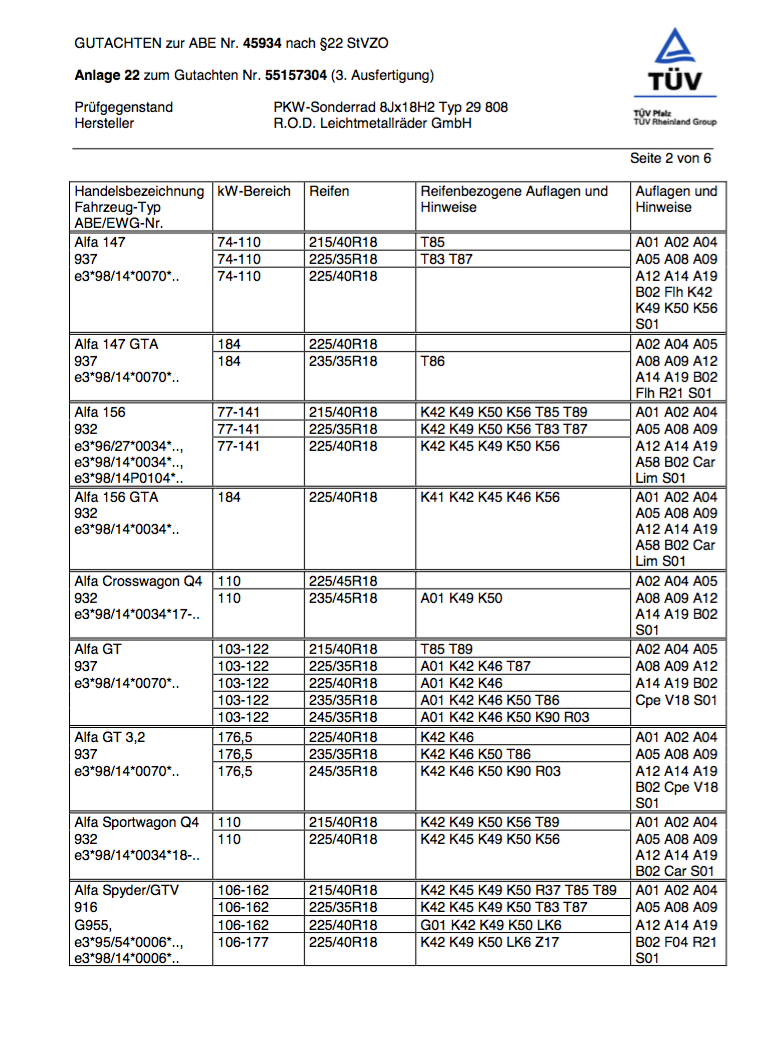

I know that there is TUV certificate in Germany for 18" (here is the page), but there must be also for 19" as there are more than few 916s in Germany with 19". In Croatia there is the "Croatian Vehicle Center" authority that can homologate modifications (usually 30 - 300 euros) if the part has TUV or other manufacturer's certificate.
In Germany 19" is possible too, but only with single homologation. For my Spider 3.0 I have homologation for 215/35/19 at the front and 225/35/19 at the rear. If someone Needs copy of vehicle documents please let me know.

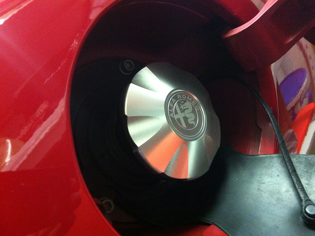

I have a new detail! :)
Aluminum fuel cap from alfisti.net. However, the story is not simple at all: Alfa Romeo changed the system completely from 2001 so good deal of 916 models is on the old system and this cap is only for newer Alfas. I thought that it would be enough to disassemble the original fuel cap and remove the plastic top but the diameter is different for a few mm and you can't just mount aluminum one on the old system. So, I had to do extensive modifications: keep the original plastic cap but cut it flat on top, then cut 3 holes to fit 3 tooths on the aluminum one and then scrub off two large circular tooths inside aluminum one so that old plastic cap could fit snugly into the aluminum one. On the end I used two-component super-glue to fix it. All in all it's a 4-5 hours job but it's worth it! :)
Wow good work !
That looks good.
