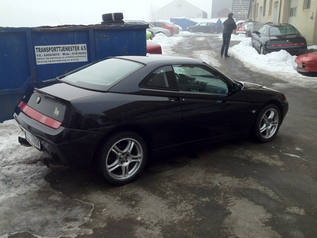

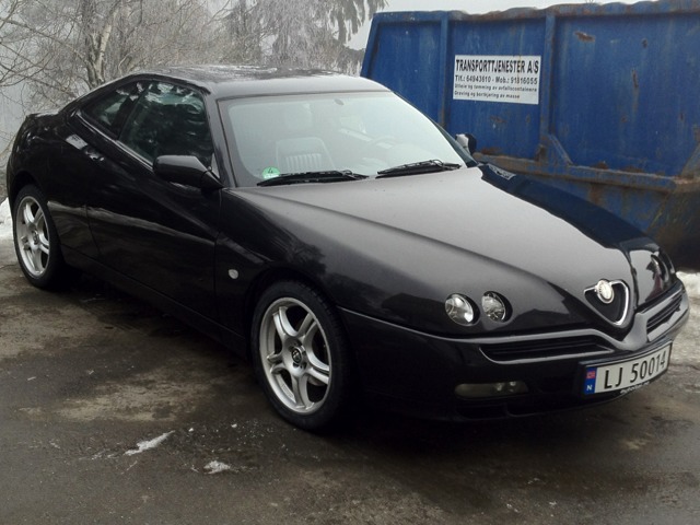

Finally! Taxes paid yesterday, and the GTV is road legal.
After hours of driving Busso Turbo I had some time to kill.. Result was that a friend of mine and myself chipped the car with squadra Chip.. What a huge difference!!! God damn that was well worth every penny! Awesome. I have no words...
Delivered it to the garage today for installation of all the upgrades!
Some pics;
Sent from my iPhone using Tapatalk
You are happy with the car and that is most important thing :). And after installation of the other upgrades I think that you will be happier :thumbsup: . I have one question, why your car was not legal to this moment, you don't pay the tax because don't drive the car for a while? What models are these wheels ?
P.S. "GTV tb" and "snow" thats are two so incompatible things to me :D.
Very happy! Hehe yes I hope so too! ;)
916 model was never officially sold new in Norway. Therefore all 916 is private imported or imported by independent dealers.
I bought this car a year ago from Germany so I imported it myself :)
This is a set of zender wheels. Looks great for wintertyres ;) I have other plans for summertyres! B)

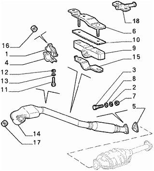

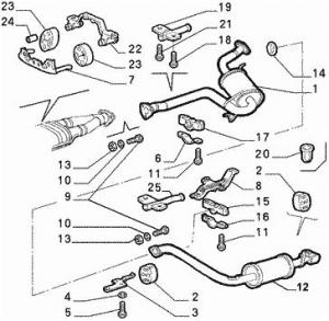

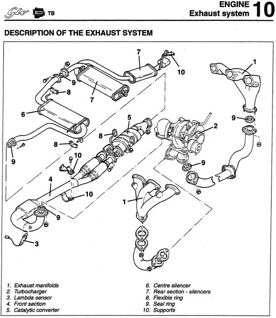

In your country probably is illegal to not have catalytic converter on the car? In old car like yours (mine is even older ;)) stock item probably is not doing his job anymore (and only restrict you exhaust) and need replacement or removal. So you need sports one. The offer by Thanos looks good, Magnaflow is known brand and the price sound good to me. Input and output will have to be with diameter of your exhaust system. Installing of universal sports cat will require custom fabrication to exhaust system! Every catalyst probably is good to some power level and I don't find Magnaflow to rate their cats. I check in Ragazzon catalog and they rate their universal sport cats to 132 KW. Ragazzon offer wide variety of exhaust products for this model (greater choice than any other brand), so if you go for aftermaket replacement exhaust parts this is probably the best choice.
In the beginning of my post I will show one diagram (from manual) of the exhaust system of GTV 2.0 V6 TB for clarity about exhaust parts.
In order of appearance :)
-De-cat mean delete catalyst so from name this replace catalyst. So if you installed one your car will not be legal (in your country) and at least you will have to remove this part and put catalyst before every MOT!
-"Ragazzon Stainless Steel Central Silencer - small" - Without EG-certification (TÜV)! This part is illegal in Germany for example and maybe in your country, so you have to check.
-All three rear silencers are with certificates (they are legal for road use), so it depend on your personal taste :). Single silencer is much cheaper, but quad exhaust have so good look :). These silencers are very good and quality products without a doubt, but they are so expensive.
The stock exhaust on my TB was quite different..
It had only the small silenser on the rear section (7)
and only one pipe on the catalytic converter (4)
hmm
I dont think mine matches that drawing either... I know that the previous owner removed the last silencer. Then I think that part number 4 on the drawing is slightly different on mine.

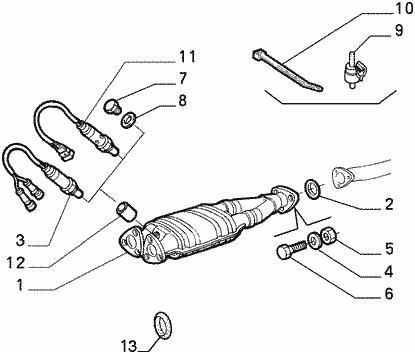

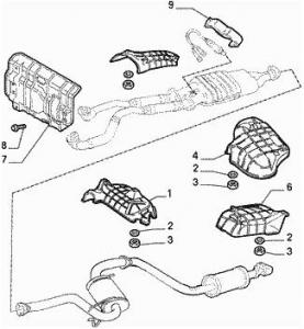

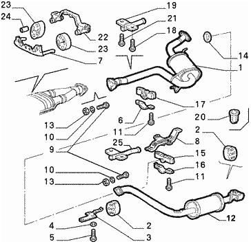

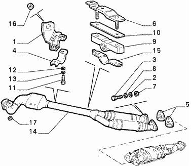

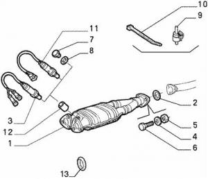

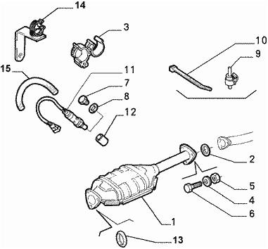

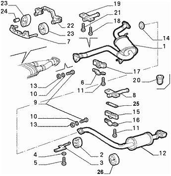

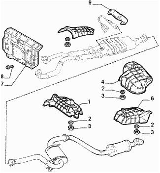

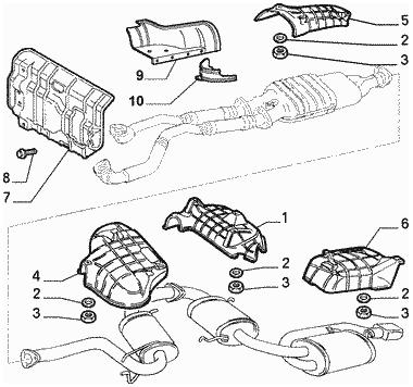

Maybe there is changes between phase 1 and 2. My car is phase 1, yours are phase 2. I made check on ePER also and here are results:
-GTV 2.0 V6 TB phase 1:
post-368-0-49333700-1362510352_thumb.jpgpost-368-0-11554700-1362510353_thumb.jpgpost-368-0-89380600-1362510353_thumb.jpgpost-368-0-86696200-1362510351_thumb.jpg
-GTV 2.0 V6 TB phase 2:
post-368-0-34763700-1362588931_thumb.jpgpost-368-0-69182200-1362588939_thumb.jpgpost-368-0-42606700-1362588940_thumb.jpgpost-368-0-92686900-1362588938_thumb.jpg
When comparing diagrams we will see that:
-from firs two diagrams (of two phases) - the catalyst is different, on phase 1 it is with two inputs and outputs and that on phase 2 is with one input and output;
-third diagrams - these diagrams are the same, but is shown part of catalyst of phase 1;
-forth diagrams - on both diagrams is shown catalyst from phase 1, but covers on them are different, center silencer is the same, but on phase 2 there is two rear silencers and end silencer is with different shape from phase 1
So after all diagrams remains a mystery about exhaust configuration :mellow: .
The diagram from manual does not match either phase 1 or phase 2 from ePER. It have catalyst from phase 1 (from ePER) rear sections similar to phase 2 (from ePER) but not quite.
So as summary there is three different diagrams. Like was sad in the "X-Files" - "the truth is out there" :D.
