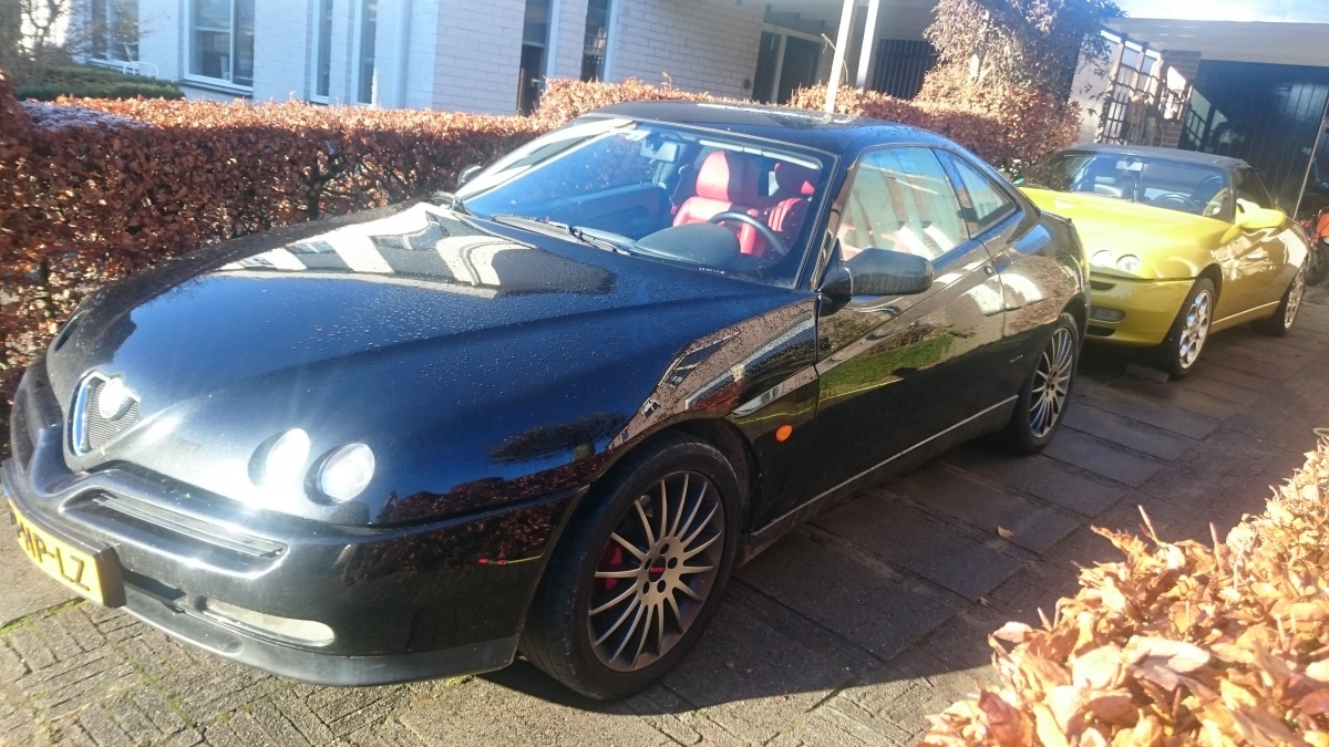

last week I have bought another small project. a very poor looking gtv 3.0 24v
the car getting a little refurbished and cleaned. then another few months driving around and resell it.
6849_1084274814957978_345623792724977527
735032_1084274741624652_3718642165605468
600397_1084274724957987_2353190124889734
After a bit of tinkering she runs again.
Luckily it wasn't a leak headgasket as the previous owner claimed.
There was s too long radiator hose mounted that a kinked in front of the radiator, leaving the radiator withoud coolant flowing through it.
which resulted in an engine that overheated and a radiator the couldn'd handle the pressure.
After changing the radiator and cooling hoses she runs perfectly again.

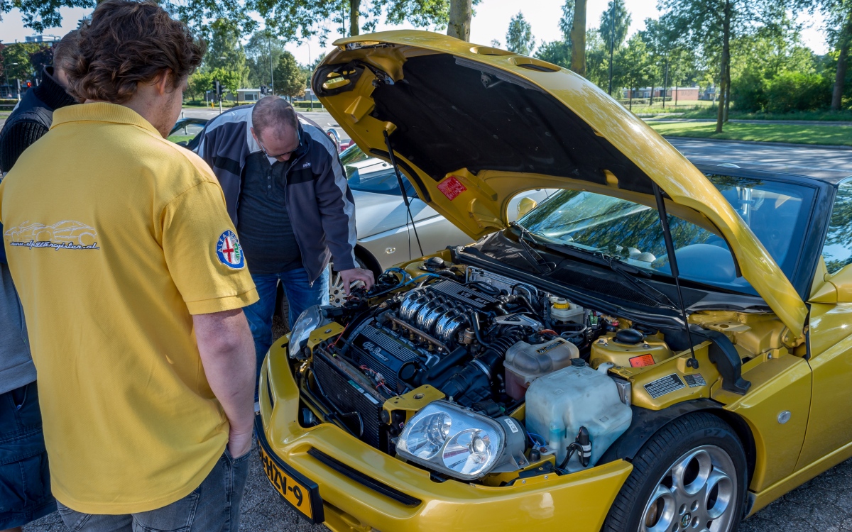

When some on polished for our Dutch annual 916 ride. only under the hood. the exterior needs polishing but that is for an other time.

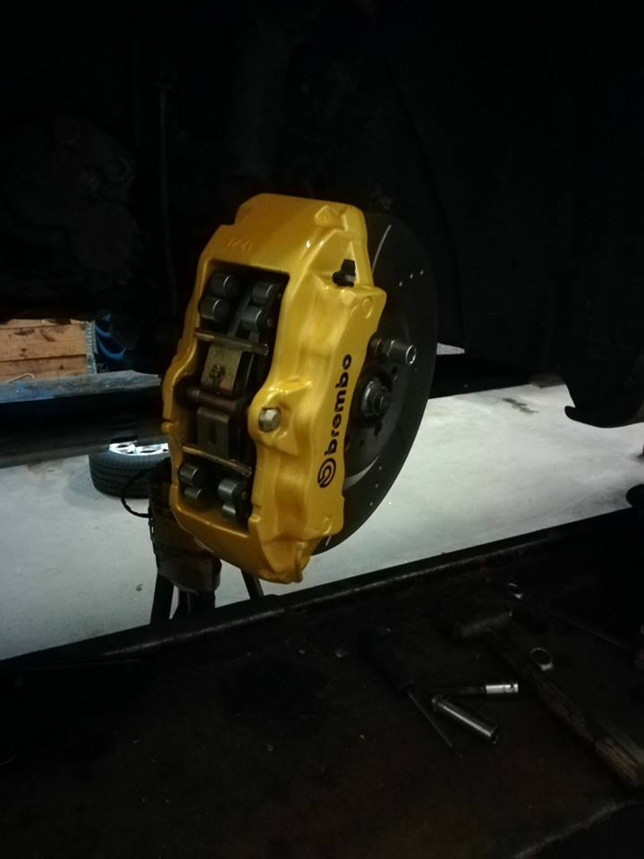

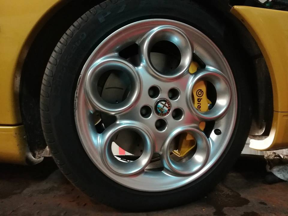

with the gtv I have don a few events. and for the spider another brake upgrade from stoch to 305mm and now for the 330mm brakes.

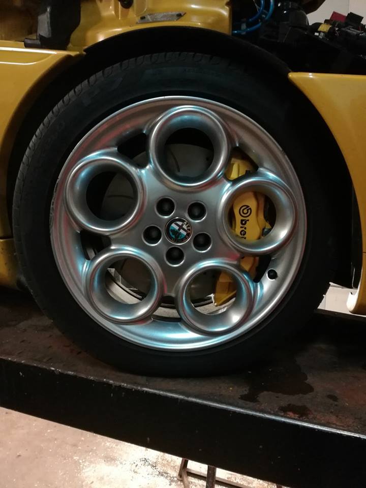

only written of som parts....  tyres brakes and the front suspension arms

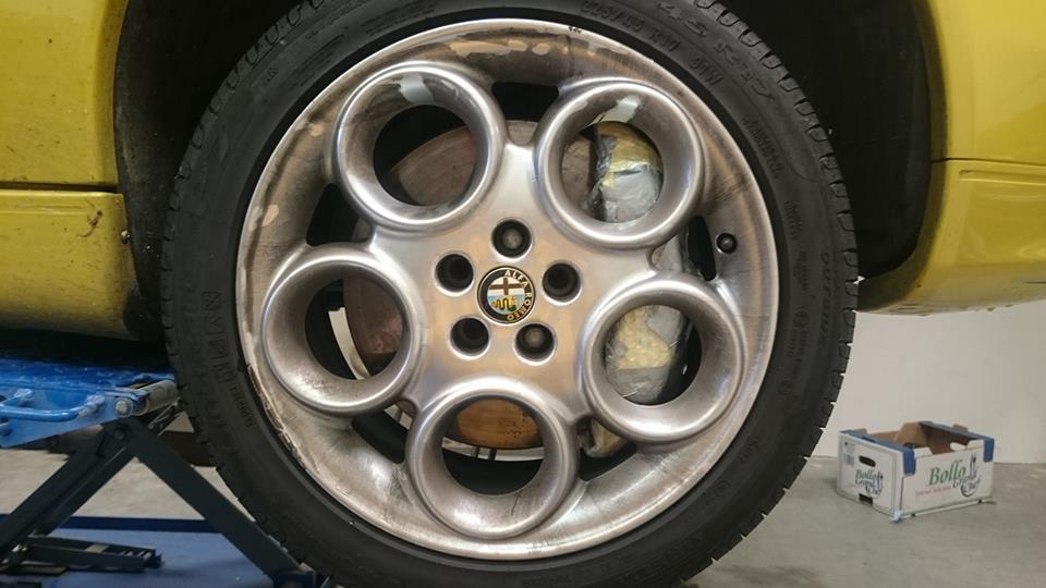

These stones on the third photograph, as punishment did somebody complete it? By the shield of 330 mm and wheel rims of 17 inches, perhaps to be problem with the space for weights for balancing the wheel.
as far as I know 330mm brakes in combination with 17" teledails fit.
joris dit it also with his spider
I also forgot to tell you that the gtv has now red carpet and motus red seets.
that he received after the holidays
3 mm is enough, if the rim weights can move between the caliper and Rim can I see no problems.

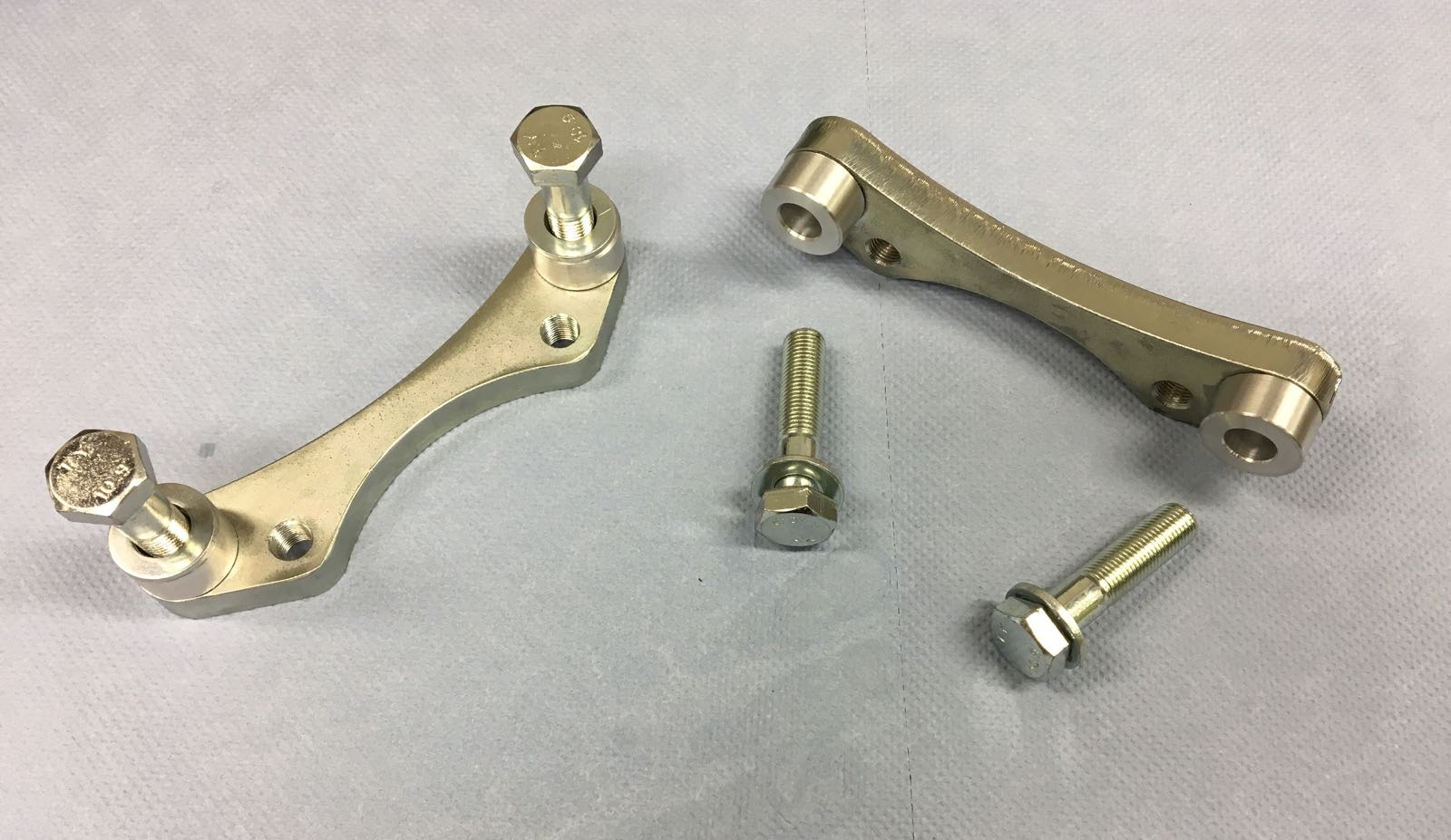

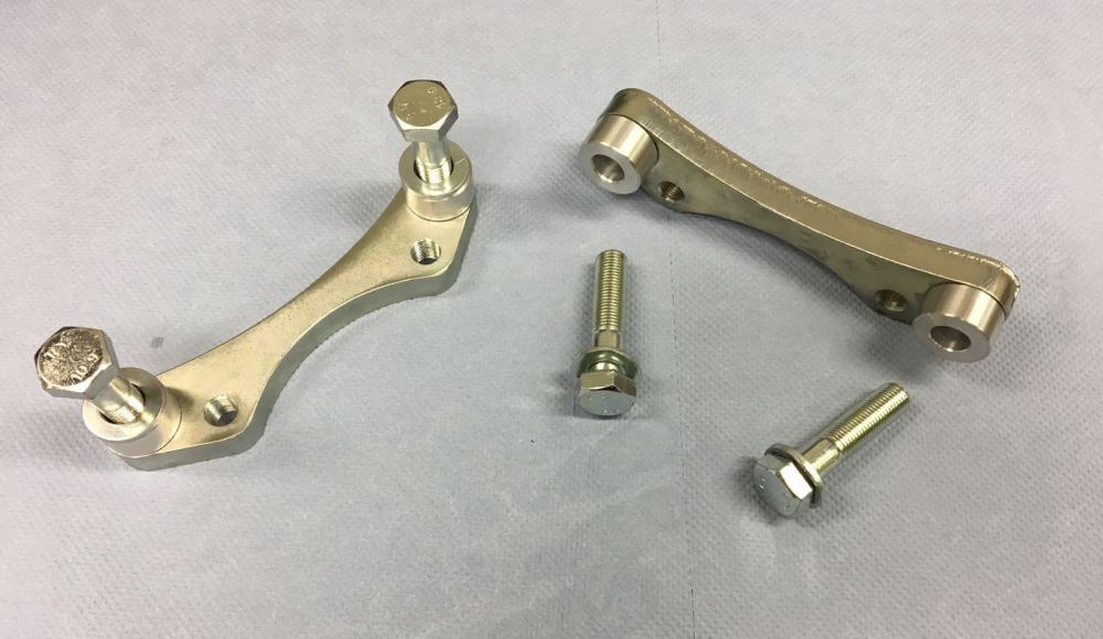

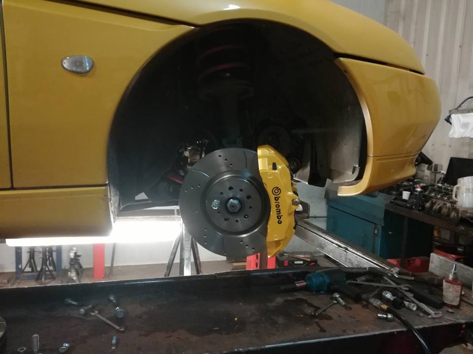

 so finally the new brakes fitted.
 Porsche cayenne (brembo z17) calipers,  gta 330x32 disk and custom made brackets
27332430_1727889523929834_292958315318550548_n.jpg.abca38215d795d014778b387423034f5.jpg
27331781_1727889643929822_2288703216395485464_n.jpg.72c4b8a2ab6dd3d9ebca82e55a04829b.jpg
27459350_1727889700596483_7014988996281804099_n.jpg.487c6244de02de5a30a58e02629e6059.jpg
27459912_1727889820596471_8427440026809268525_n.jpg.b064231fd771e4bf2a41f8c86a85a45d.jpg
and the diffrance in brake pad
brembo z17 - 305/330 alfa - oem 1 piston caliper
27332523_1727889877263132_1854439478366484211_n.jpg.45b57d3258cdf7f3891ff993c32fb542.jpg
