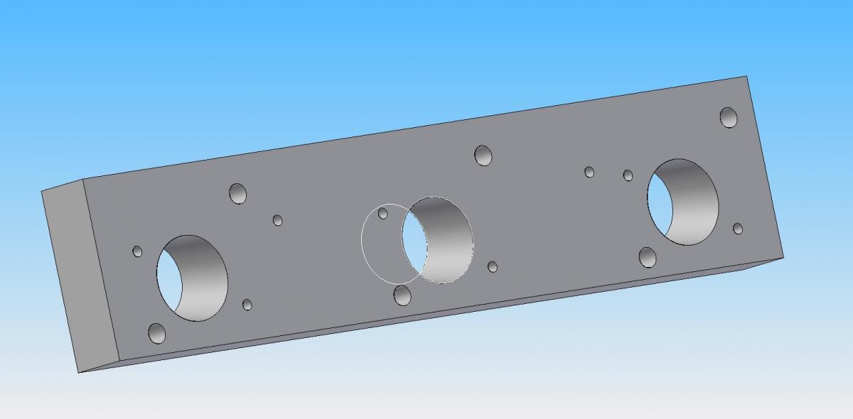

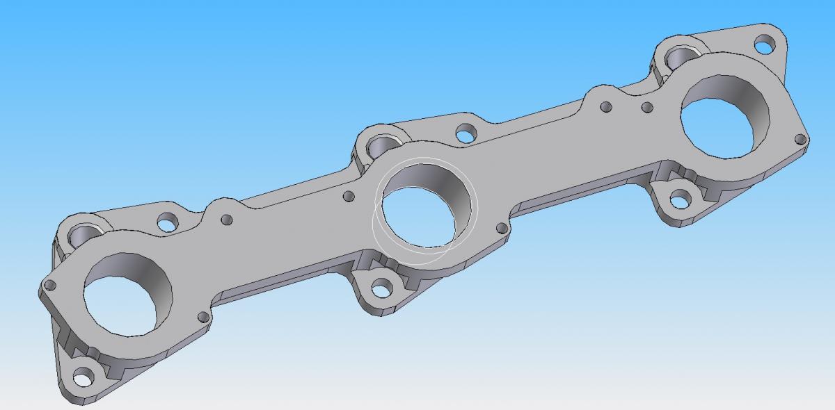

The 3D model is ready: adaptor plate from 12V head to 24V inletpipes  :thumbsup:
Edited by Carlo
You need two for one engine.. :)
When the numbers get bigger, the prices get lower....
Don't ask me about that price because I have no idea, yet..
I made the model in a way that it is possible to make it with a simple 3 axis CNC mill. Even with a coventional mill it's possible with some improvisation....
Maybe it's an idea to make small production run of 10 pieces or maybe some more if there is enough interest. :thumbsup:
Problem is, although I made great effort to make the modell as accurate as possible, they are not yet made and tried... So there is no garantee for 100% perfect fitment... yet.. B)

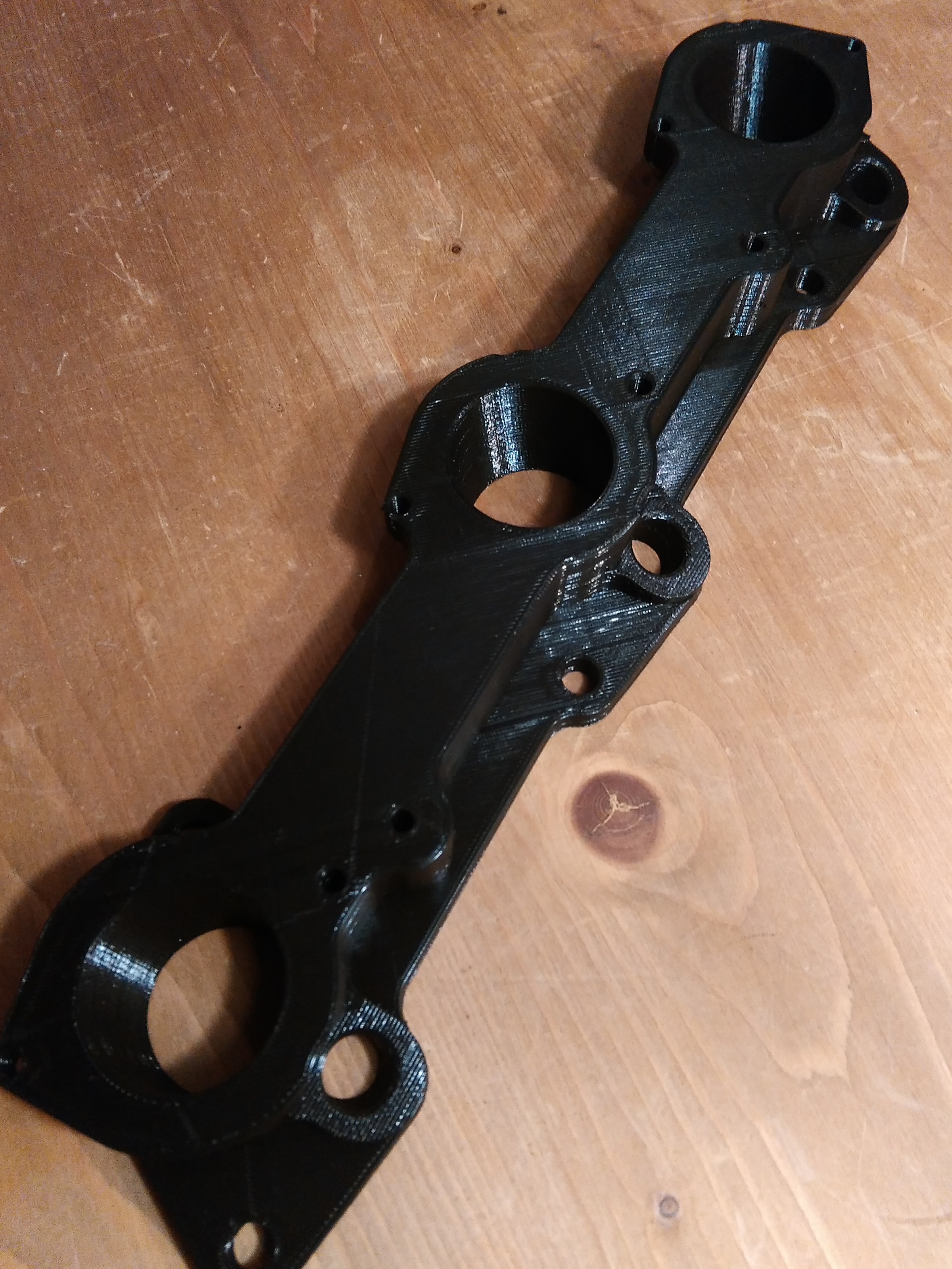

test model:happy0045:
Sorry for the super slow progress... :huh:

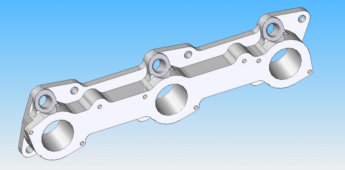

I checked the 3D print and found, of course, some little faults... The most important one is the fact that I offset the mounting holes for the 24V pipes to the wrong side! :rolleyes:

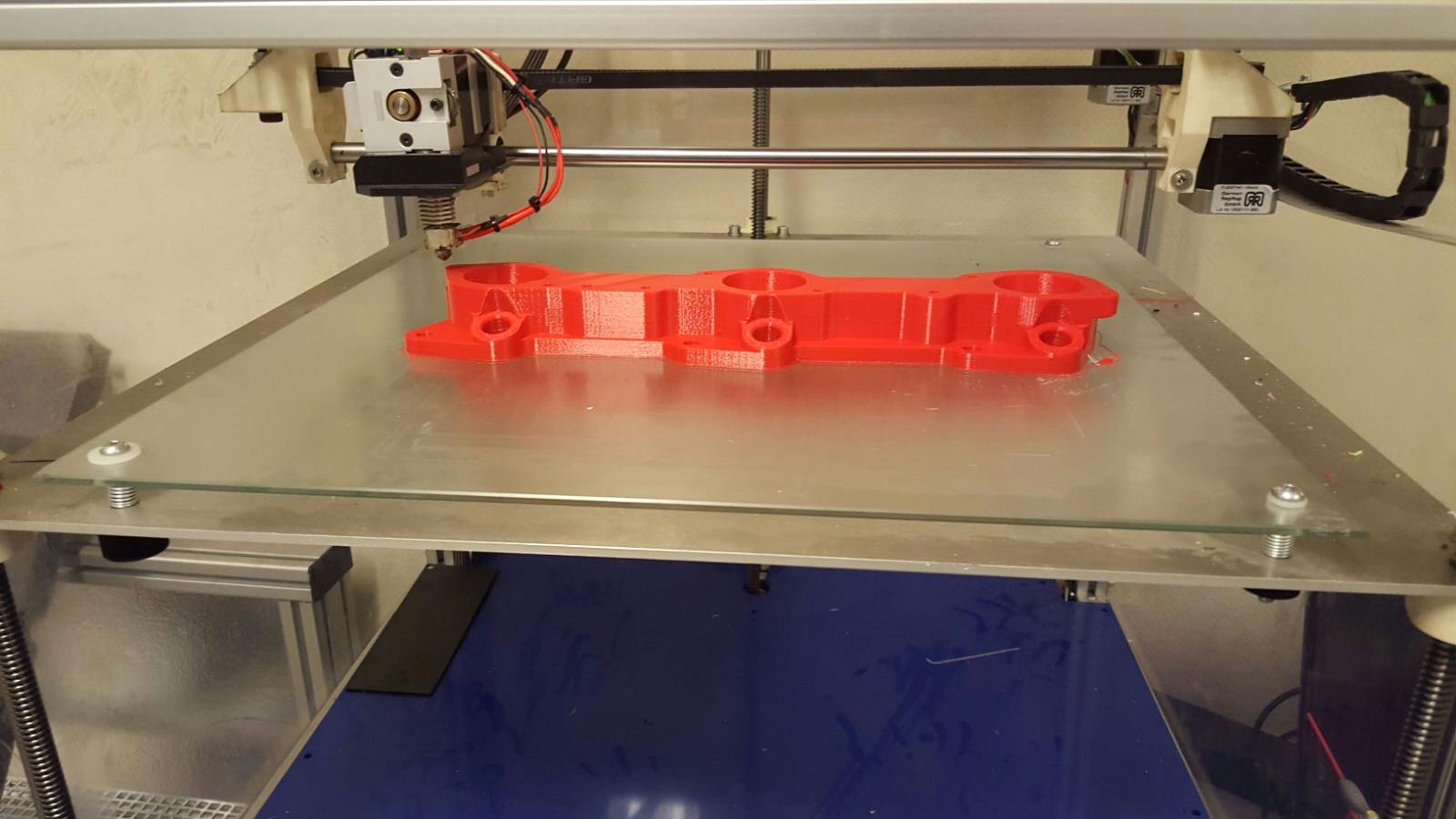

Extra problem is that I have an other job where I have not the same CAD system... So I am planning for "a coffee" with my old collegues... So I can use my old CAD system to make the changes... And let them print a new one!
In orange this time!
So far I can see the 24V inlet pipe fits well this time. :-)
