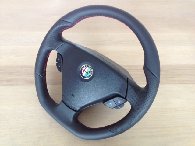

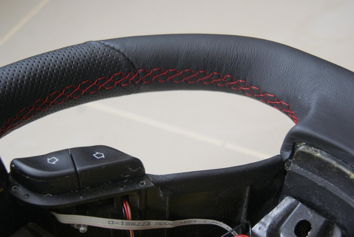

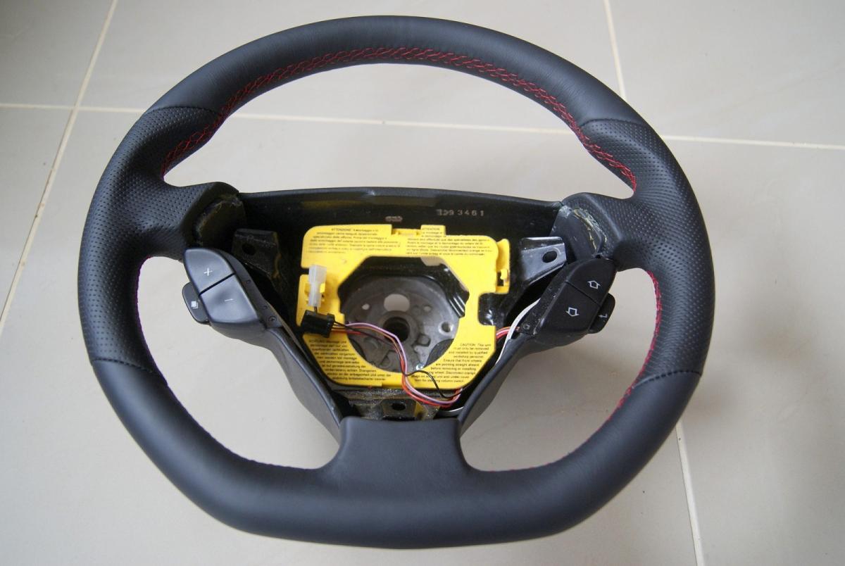

I saw a few 166s with those steering wheels. Could even get one for myself a few years ago, but I didn't think I could get the buttons working.
Well, like i said before communication is a problem with the steeringwheel guy...
Told him yesterday to leave the red stripe and its oke the way it is.
Didnt get a reply so sendid one again today, the end of the day i heard that he didnt checkt his email.
The leather was already stripped off and new is going on tomorrow without the red stripe... :smile25:
haha.. It was kind of cool with the red stripe, but better all black with red stitching ;)

Steering is done! Hoping to have it back home within 4 days.
Very pleased with the result. :wub:

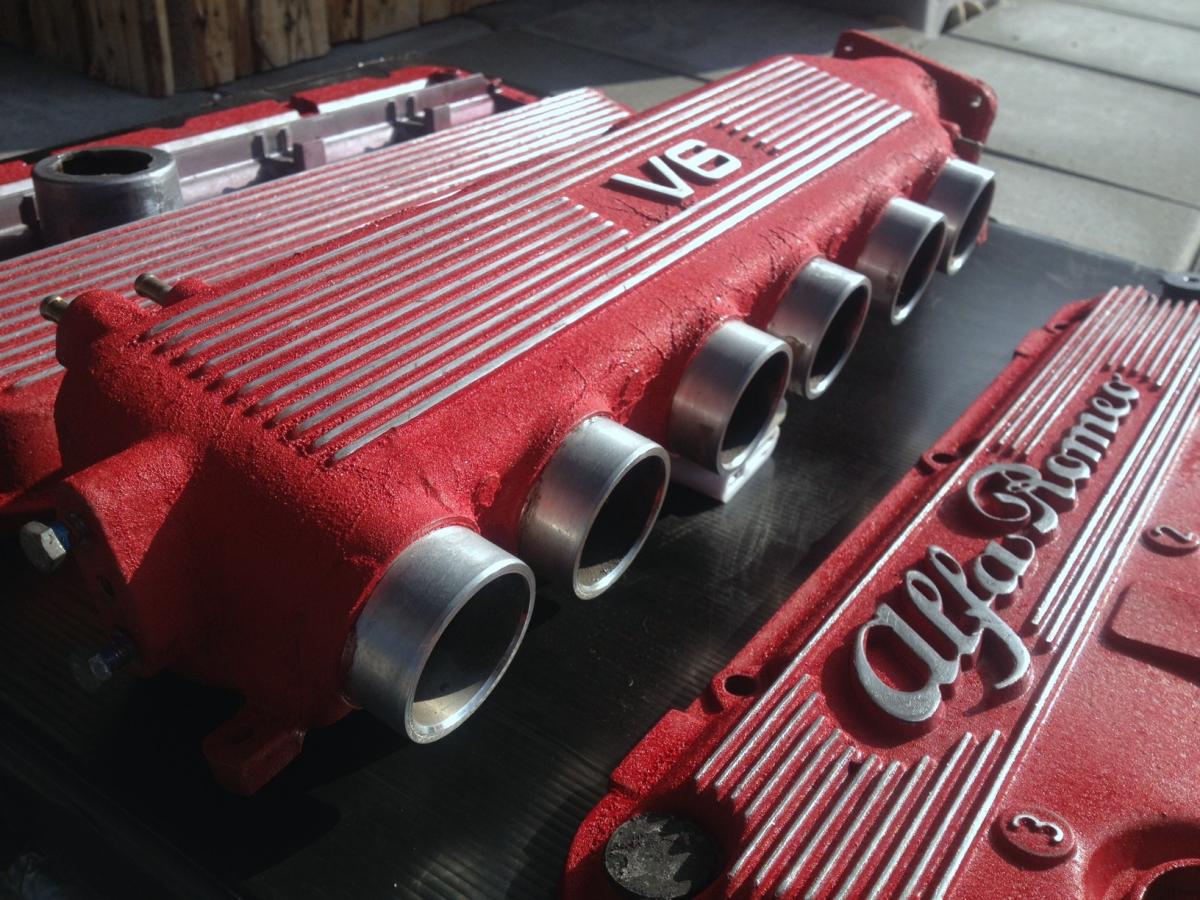

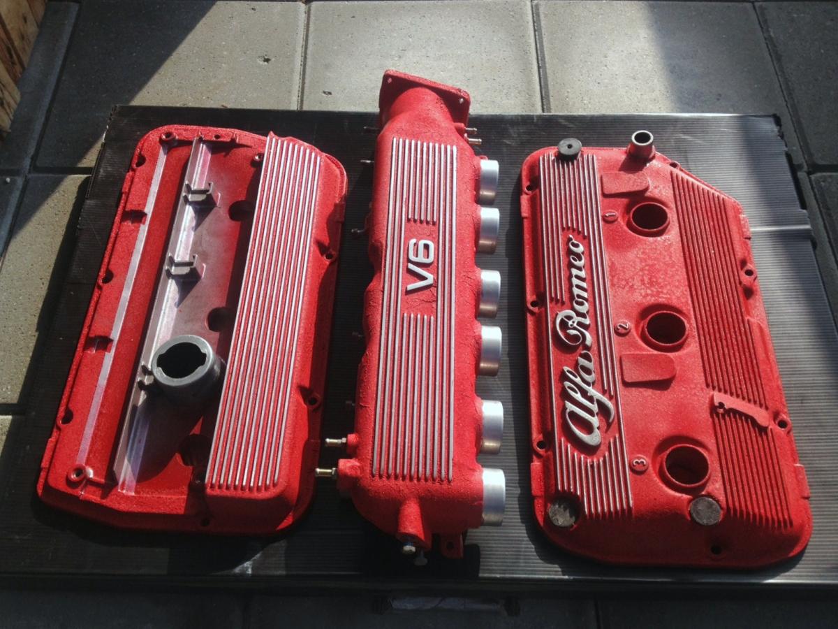

Engine is getting big maintenance on the camshafts, new lifters and cups timebelt etcetc :mellow:
Nice moment to work on the engine cover and intake!
Sprayed them with red wrinkle paint, already had the smaller cover at the front.
Polished the ribs, happy with the result.

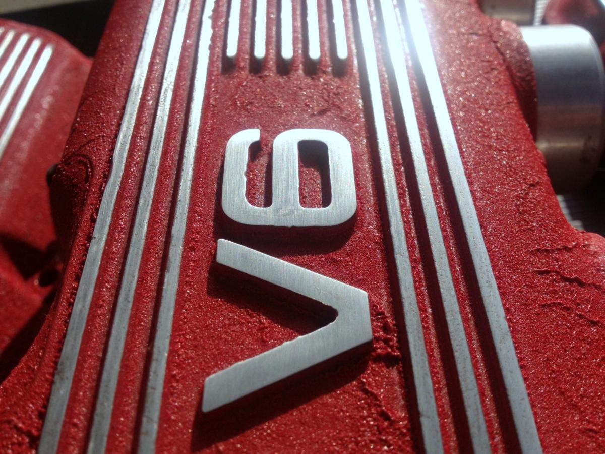

Did you make some preparation (cleaning, polishing) of cam covers before using of that paint. From very close that paint looks very strange to me. Maybe there is some specific method of painting with such paint. But I really like red covers with polished lines and inscriptions, very good combination.
The steering wheel looks very good  :thumbsup: .

Yes, First you have to wash and sand them a little so they are clean, don't have to be smooth becouse you want structure.
Then you degrease them and they are ready to paint, make sure its 20+ degrees outside.
When you spray the wrinkle coat at first it looks like normal paint.
The wrinkle/shrinking starts when you bake the parts for 20 min every layer in the oven at 125 degrees.
You whil see some result at 15 min.
The intake and little front cover are the best looking this got 4 layers, the covers got 3.
After 1 day drying the transformation is complete you can sand the ribs with 150 - 400 -1000 to polish.
I did al the parts with one spraycan.
Make sure youre wife is gone for 2 days... :rolleyes:

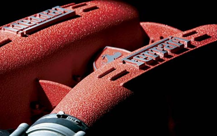

No 2K. Its called wrinkle paint, they use it standard on the Ferrari intake manifolds... :)
