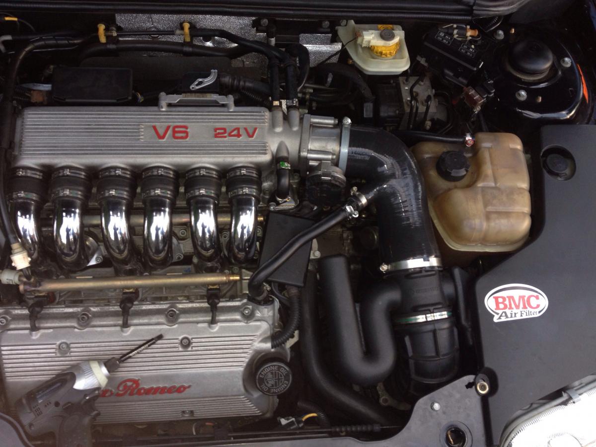

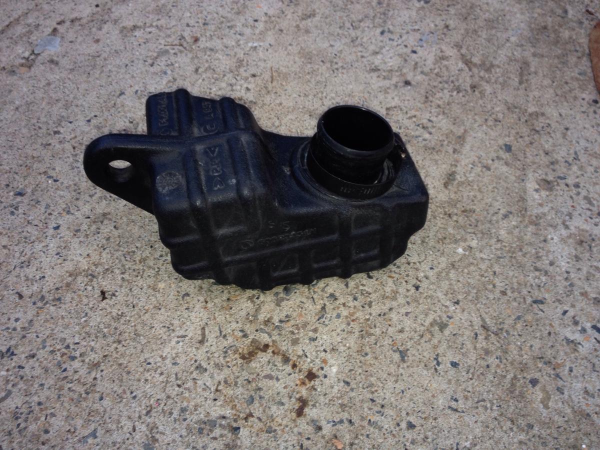

First job when collecting was to change the split pipe, no major problems, neat and tight fit. However can anyone tell me what the empty plastic tank is for - it connects to the underneath of the standard flexi pipe set up but not to the replacement Autolusso part. I can only think it reduces air pressure or collects condensation - pic below.

Lovely car you have :thumbsup: , regarding the empty plastic tank on the intake do a search on Helmholtz resonator, it's a device to
tune the intake sound or performance or for both aspects.

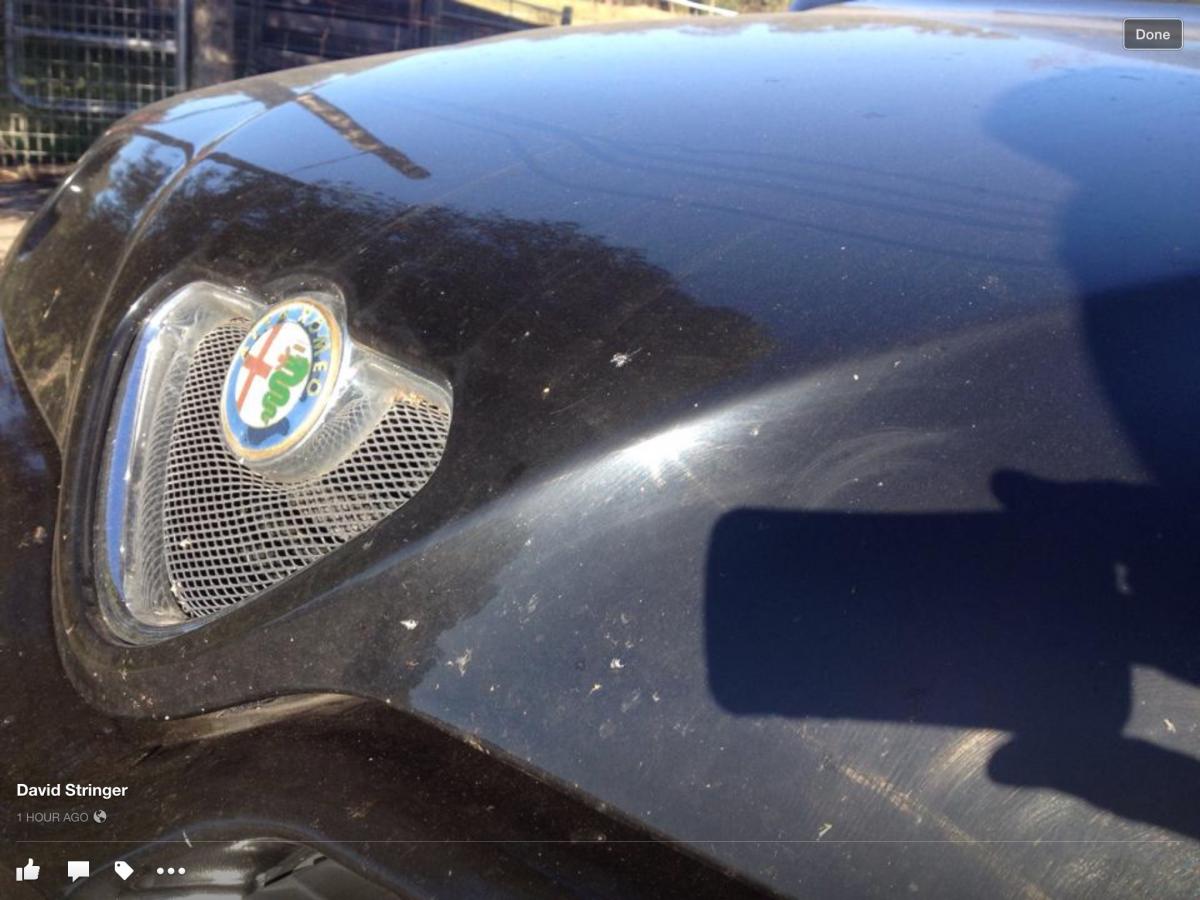

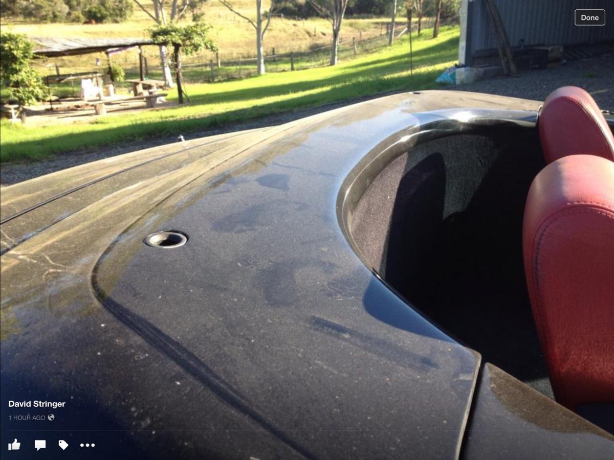

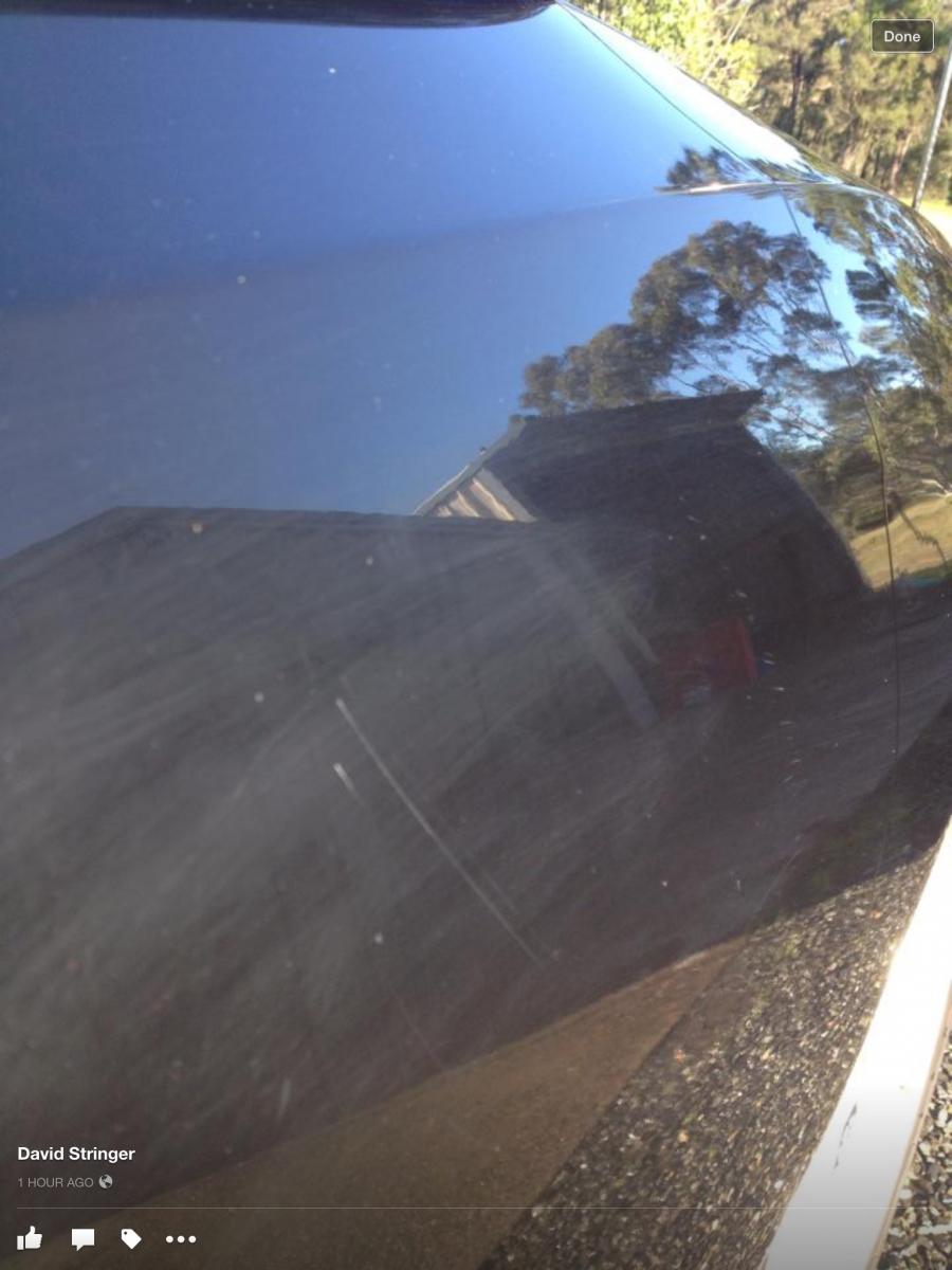

So, I thought I would share a few photos. I am thoroughly disgusted with myself for allowing my lovely Spidey to get into such a state.
post-755-0-96262600-1431321279_thumb.jpgpost-755-0-75880500-1431321255_thumb.jpgpost-755-0-51608000-1431321323_thumb.jpgpost-755-0-90654600-1431321348_thumb.jpg
To be fair I dislocated my knee in December, followed quickly by a herniated disc which I had operated on just 10 days ago. An amazing super-fast recovery coincided with my fiancé being away for 3 days - giving me a perfect opportunity to get in the Man Cave undisturbed.
Here's the process - it is the first time I have ever done a full and comprehensive detailing.
1: Shower off the dust 2: Soft Hose Brush wash 3: Sponge soapy hand wash 4: Clay Bar clean 5: Meguiars Cutting Compund with Cylco Dual Action Random Orbital Sander 6: Repeat Step 5 as there were still lots of scratches 7: T-Cut Black with Cylco buffer 8: Auto Glym Super Shine Polish 9: Meguiars Carnauba wax. Plus clean and detail the interior and feed leather.
3 Days! - it will be faster next time.
