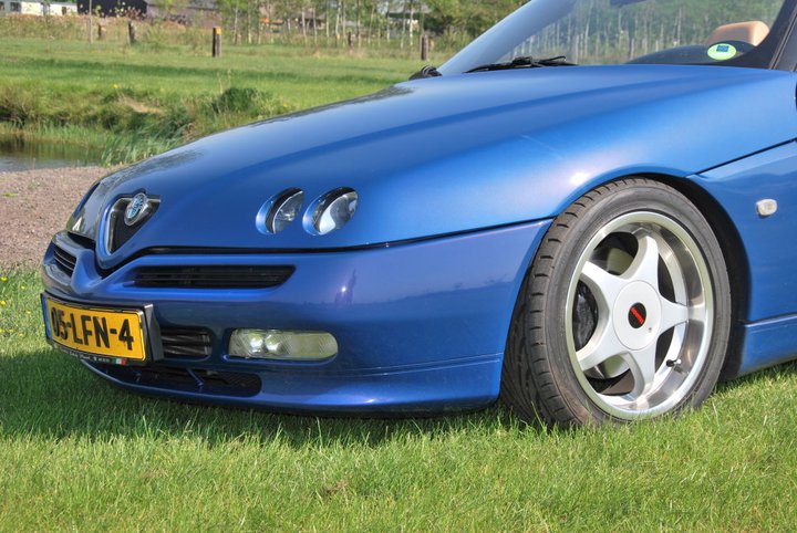

hey guys,
My name is Chris 23 years old and living in the Netherlands.
Ive heard about this forum at www.alfagtv.nlso that's why i joined this forum aswel.
About the Alfa Romeo Spider its an 7 colours painted 2.0 16v Turbo.
Originally it was an Novitec Turbo but i rebuild it.
Optimise the oil cooling
Other Intercooler
Bigger Downpipe
Sportcat
Turbo Pressure meter
Other gearbox
Bigger Brembo brake calipers
Powerflex front and rear
Coilovers front and rear
other pistons&valves
Lighter flywheel
Bigger airfilter ( straight attached at the turbo )
spacers 2mm front & rear
Zender side screen
Novitec DTM exhaust ( will be change, i dont like the DTM look )
Manipulated Computer
Higher turbo Pressure
Then i own an Fiat Seicento 1.2 Turbo with about 200 bhp. At +/- 600 KG

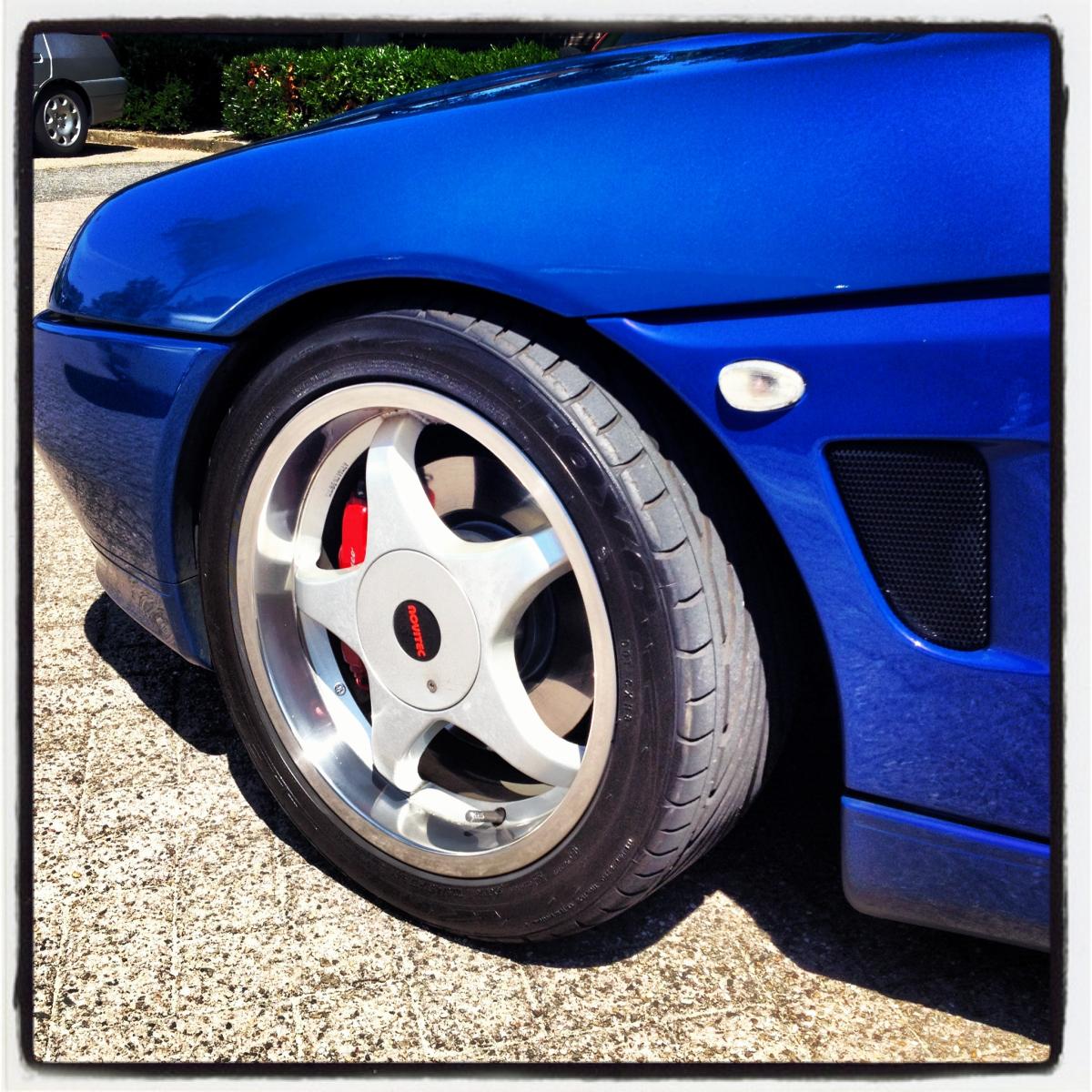

Are these brake calipers from an alfa romeo mito?
Yes its from a Alfa Romeo Mito or Alfa Romeo 159 TI. With Falco Motorsport brake pads.

I think that the Mito and the 159 have different calipers. The one from a 159 are bigger...
Anyway, what is the size of the disks?

These are from the Mito ( you are right ! ). The disks are 305 mm.
Are they "plug and play"?
I mean, you did not had to use any extras brackets or any other mod if I am right?
its almost plug and play. I need to use other brackets ( specially made ). And because i have 17"wheels didnt need any spacers.
Nice Spider!

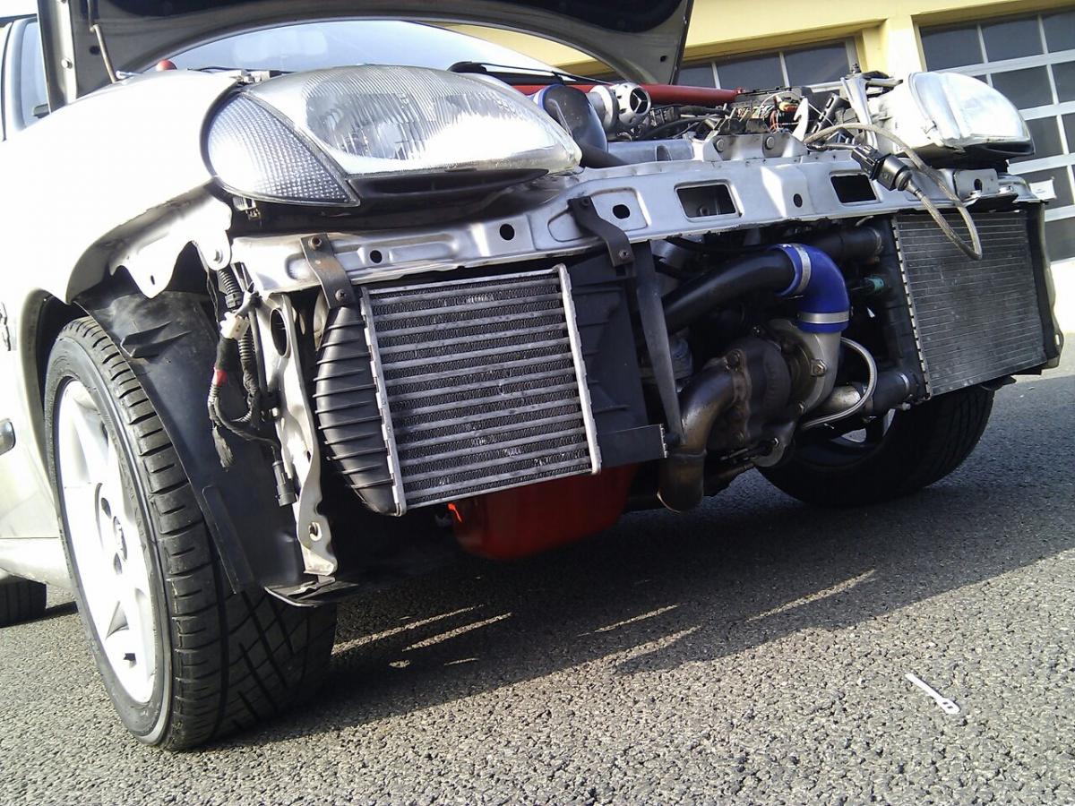

Can you tell me the size of your intercooler? I'm thinking og getting a front mounted bigger intercooler as well.
Nice brakes. Are the pistons on the Mito caliper is slightly bigger than on a 3L GTV/GTA 305mm caliper? seems so at least.
Nice Spider!
My advice,
you do not need a bigger intercooler if you still have the T25.
The OMP one is just fine until 250 bhp.
About the calipers,
yes they are bigger!The pads also.
Way better that the GTV/GTA/Fiat Coupe/ etc..

Well I already have the GTA 305mm brembos, so will use them first. If Im not satisfyed, I will jump to 330mm...

If you already have 4pots in your GTV there is no reason to bother.. :thumbsup:

Is your previous brake calipers from BMW e38?

Yes the previous brake calipers are from a BMW ( dont ever use it for your 916 it sucks )

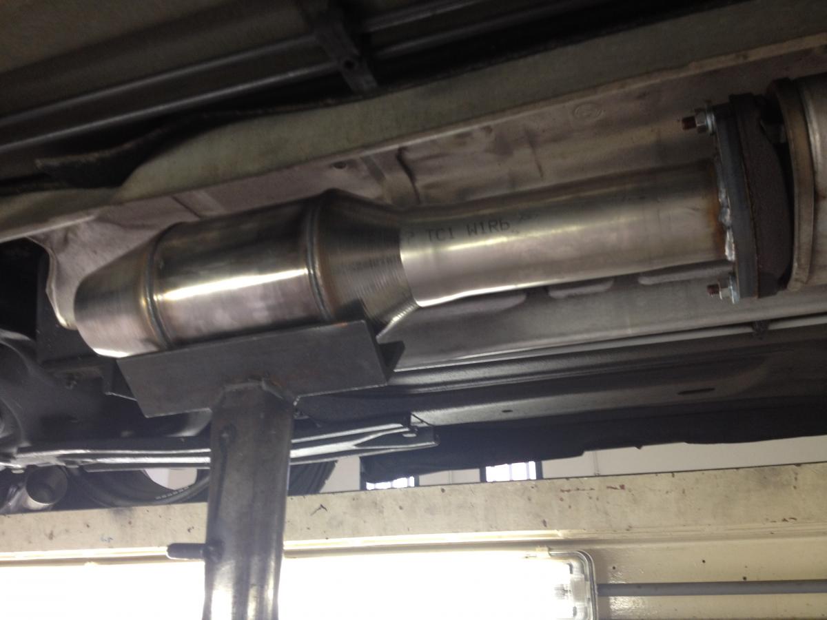

*update
New wheels ( toyo's )
New seat's electronic adjustable

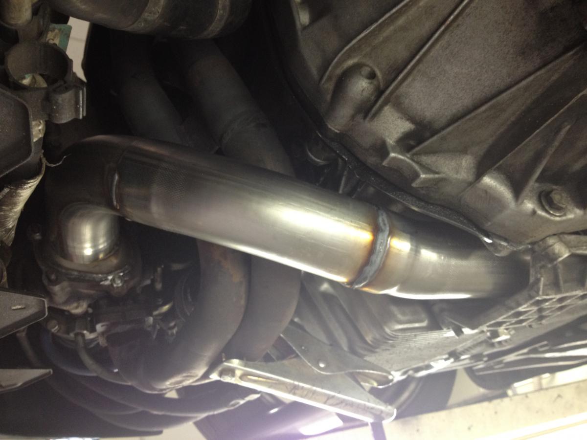

New custom made exhaust
New wheels
New springs
What spacers are you using? Looks like both front and rear spacers... what size and brand are they?  :thumbsup:
