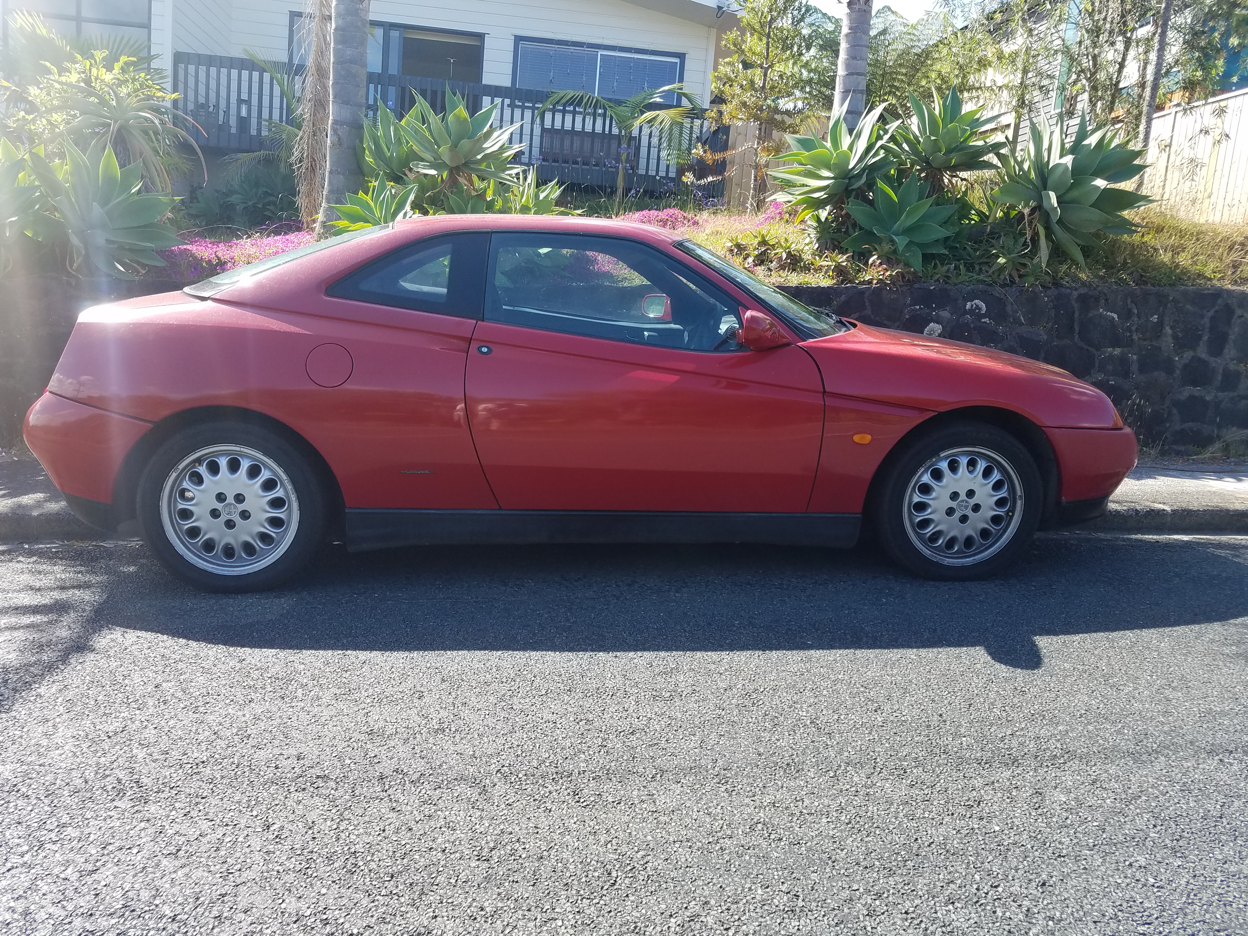

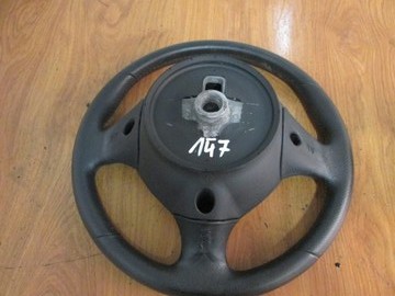

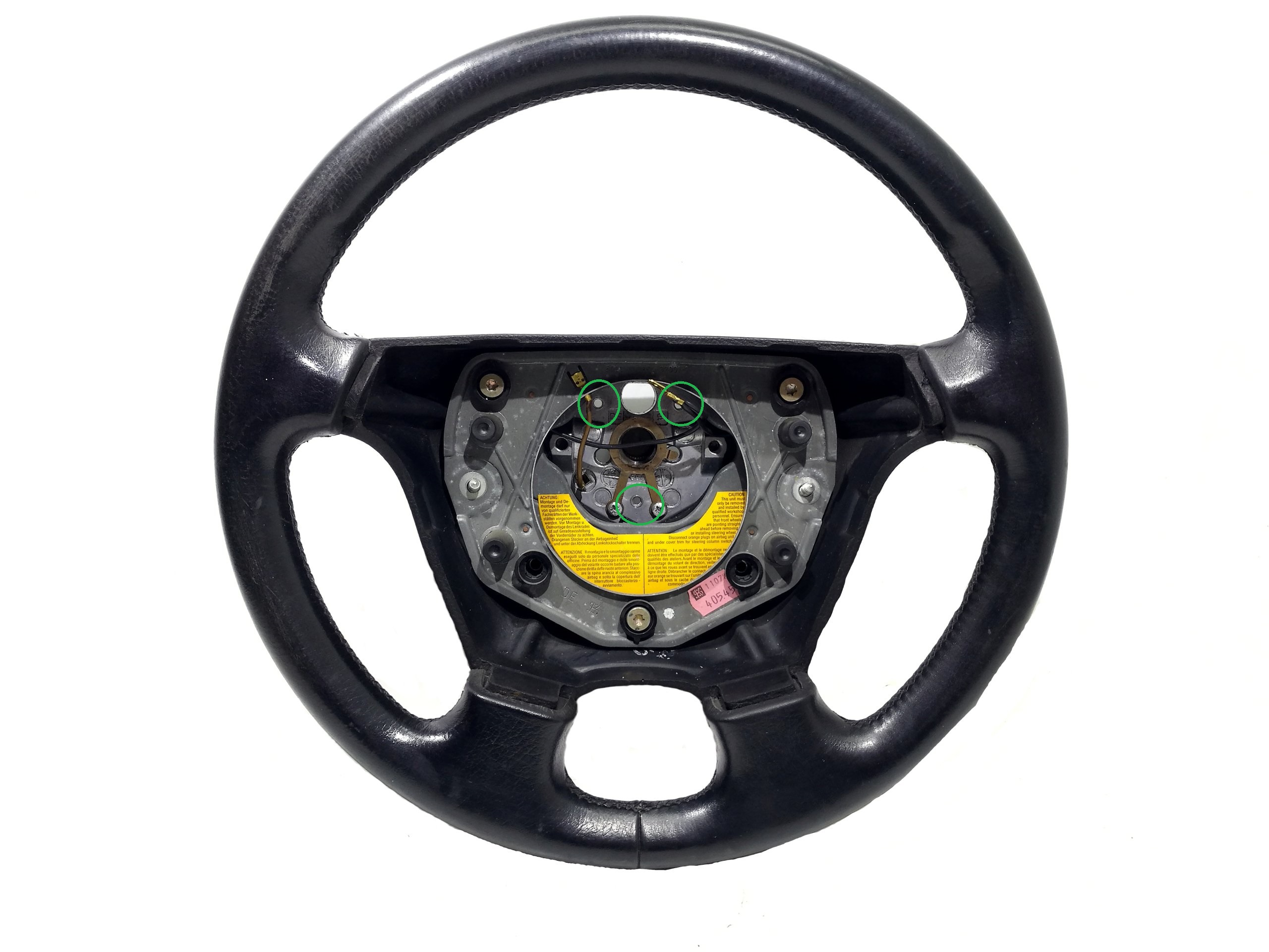

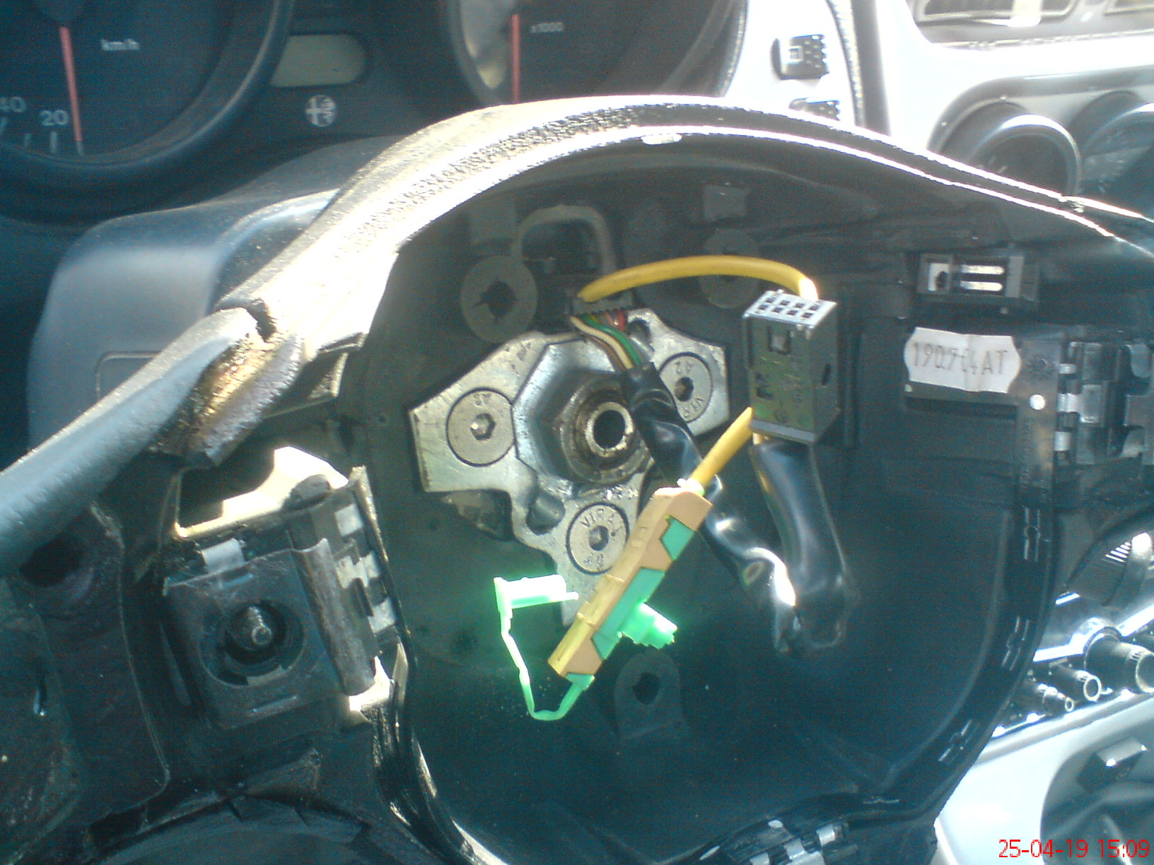

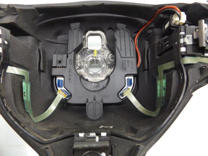

Kia Or a from NZ... I'm looking at buying a 96(?) 2.0 TS, which is a little rough around the edges but seems to run and drive alright. Being an earlier car it has the ugly wheels,  and that honking great four spoke steering wheel. Having had a look on here it seems that the 147 Selespeed wheels should be a good replacement,  but i'm wondering about that hideous steeringwheel.  I'd prefer to keep the airbag in the car,  so I'm wondering if a 1. 6 147 wheel without the buttons could be made to work without too much agro?
Thoughts?

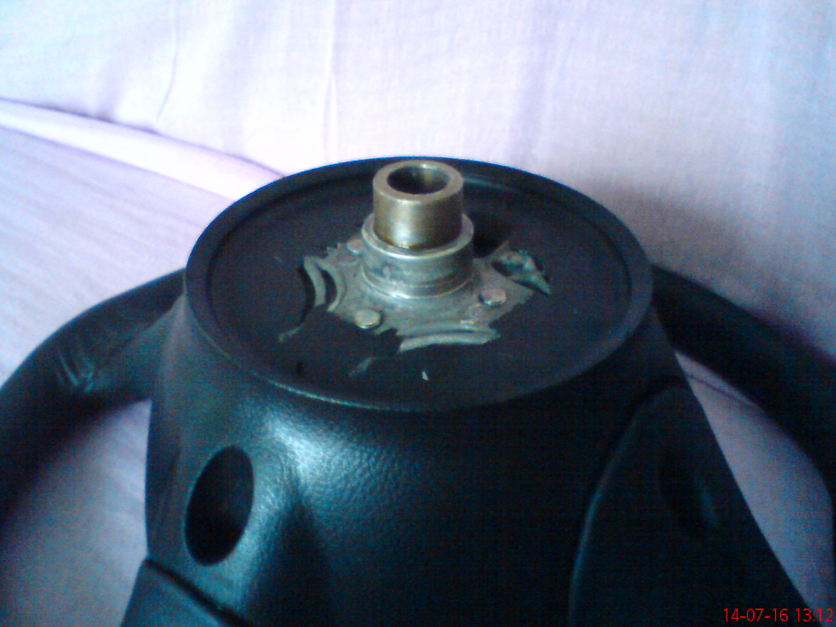

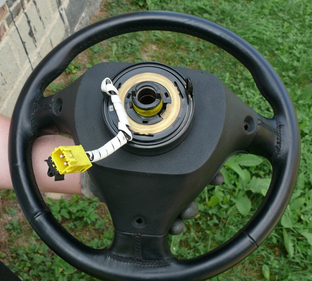

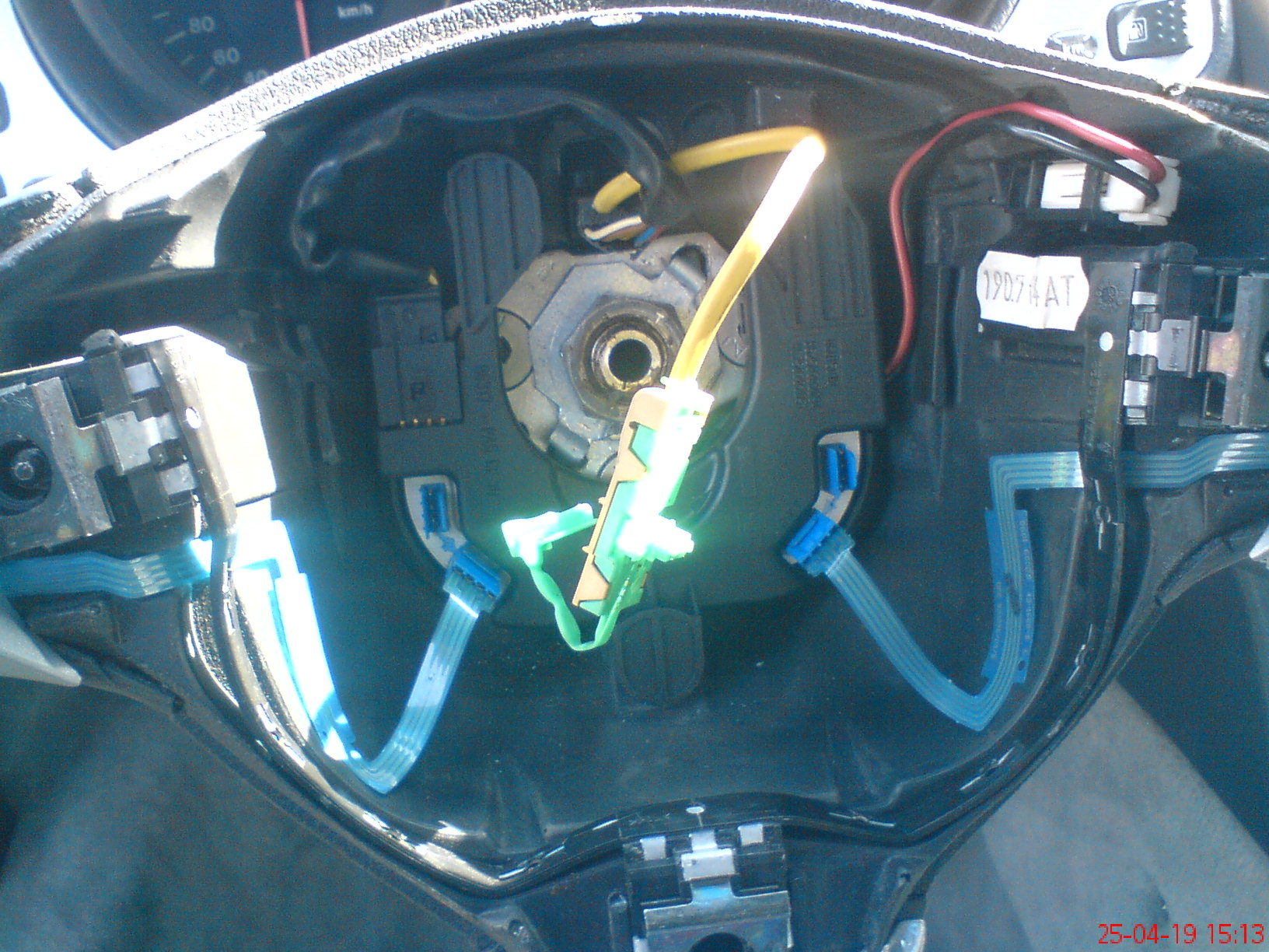

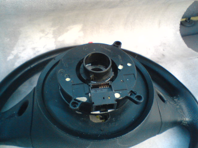

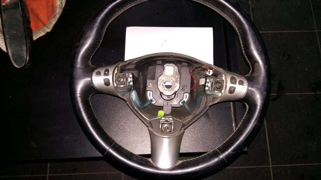

The handlebars have other multi-grooves.133.jpg.6a63d411c116e736e3c624f9f2b1547a.jpg6035856325.thumb.jpg.83837d7746a4c746749cbf2a390769b3.jpg5134908657_3.jpg.d1257e8ff3808a0e954d0417c1f728c9.jpgDSCF0472.JPG.6a440d792c5d0021c48c42fa0935ee2e.JPG147.thumb.JPG.310de21ec1d2bc7c8570f4a6f727c527.JPG141.JPG.e4241ec9150c6a459cdd7f0df45b8fc9.JPG001.thumb.JPG.efeae8ece77ff048654b30de6669fe6f.JPG145.thumb.JPG.babe181ff791891d90ca2f4fdd76f166.JPG149.thumb.JPG.10a6230b2e2af8be9d81550663b05b3a.JPG148.thumb.JPG.53129b7a16856d329a932673e83c3781.JPG146.thumb.JPG.708af44d0a1de217b6c1084fcab90413.JPGa4943f4744988c495354299bc430.thumb.jpg.1030a64eecbf3b83c30e855cbdb84fc7.jpg89fa4996424291a74957722eda41.thumb.jpg.0442e36988220fe32ebb406ade62a6f3.jpg6027911645.thumb.jpg.78578949c5ea6f2422652a3cc31d22a5.jpg

Thanks for the info;  Looks like more work that I was anticipating,  but it looks really good in there.
