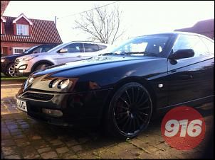

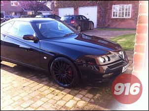

    I don't think you need the whole cup kit to look finished, i think this gtv looks good with just the front splitter nut i do like to be different and there are alot of full cups about. yeah the spoiler is nice to i had it on my old red ts gtv but not on the blue, sometimes i like it without the spoiler and other time like it with out, so if i can find a boot with one already attached i can swap it over as and when. One of the things i love most about the 916 is playing around modding them and how easy it is to swap something out/over. While adding alfa centre caps i though the wheels would look nice silver so half tempted to have my alloys powdered coated. I will have to learn how to photochop upgrading and modding is endless
  2. Alfa gtv v6 project black edition
    there is a place ten minutes from my house that makes the cup kit, i will have to pop in and check the quality, how convenient http://www.ebay.co.uk/itm/Alfa-Romeo-GTV-CUP-FRONT-SPOILER-GRP-FROM-ORIGINAL-/231450689579?pt=Automobiles_UK&hash=item35e389402b I think im going with this look, just the splitter and side skirts, i like the clean lines i could alway save up for the ti alloys and add at a later date
  3. Alfa gtv v6 project black edition
    They were 17 fox alloys easy to get hold off if your after a set. I prefer 18 and 19s although I have acquired a nice rare set of 17s. Not sure were to spend my bonus, a cup kit well splitter and side skirts or 19 ti wheels? Heading down to Cheltenham on Tuesday to pic up a few bits Full stainless steel exhaust and downpipe, powerflex dog legs, alternator, lower light, rear callipers and compensator. a coolant tank, heater relay, and the silver centre surrounds to trial spraying black. all for the mot, this is the last mot advisory sheet advisory 8,7 and 6 sorted the parts i pick up will sort the rest
  4. Alfa gtv v6 project black edition
    Thanks Charlie, sorry but I have never been a fan of the red leather interior, it reminds me of a bmw's and it's very pimpish in my humble opinion. The plan is to track down black carpet and headliner and go all black, then if I fancy a contrast or change I can just swap the tan leather off my spider as I have kept the back seats and head rest. I do like black and tan I think Black and Tan goes nice just need to replace that Grey carpet. On the subject of swapping I am also on the look out for a boot with zender spoiler so if i can that look I just swap the boots over as and when i fancy it rather than drilling holes and painting. I think I'm going for the cup splitter and side skirt but not a fan of the side vents I want clean looking lines. I have not had the 156 sport long but can't help have a play with it, took it in and had all belts done I fitted a new driveshafts, wishbones , drop links and track rods. The wheels I added are golf r32 alloys as they compliment the grill, like the gt blacklines compliment the front lights on the spider. I might even put the blacklines on the v6 to see what the black 19s look like against the rosso red paint. mmm blacklines and tan.....and then a cup splitter n side skirts

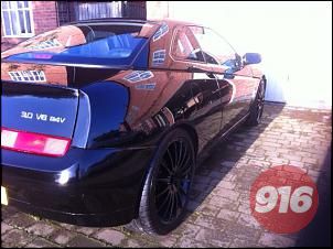

    Im tempted to spray my centre console black but not sure so after finishing the interior off, door cards in, carpet, leather interior, italian gaiters and sony cd player all fitted it was im eto sort the engine out. connected the v6 up to laptop and showing a maf fault I managed to source a good used bosch maf for £35 so happy with that while swapping the maf over I found a big crack in the air intake hose leading up to throttle body at the back on the corner. while i was playing with the engine bay i thought why not give it a quick once over, i had some shinny chrome pipes i bought before i even had a v6 (they were a bargain at £35)i couldn't resist. i popped down to halford and bought some metric heat proof paint and after removing the two covers and giving them a blast decided i would paint the fuel rail silver and cambelt cover black, so back down to halfords. I spent about £30 on paint. I need a intake hose and while looking i spotted another ebay bargain and ordered a used red silicone intake hose for £20 including delivery and ordered a nice shiney oil breather pipe for £3.99. while taking everything apart i found the cause of the lump noise a large crack in the gaskets on the chrome pipes. I ordered two green chrome pipe gaskets as there were both cracked but only £8 from main dealer. so maf sorted and engine light off, plus i painted the engine bay looks much better. I decided not to tackle the v6 camblet i will take it to a specialist, i did one years ago on my old ts but and v6 is way out of my league. to be honest the red isnt red enough for me and i still need to paint the lettering but looks way better than it did and only cost me just over £100 before/during/after (still got coolant tank and lettering to do)
  8. Alfa gtv v6 project black edition
    So with money put aside for a gearbox i didnt need the money was spent else where THE GOODIES new front grill and badge £50 new rear badge £25 new Italian leather gaiters for handbrake and gearstick £40 clear side lights (didn't go with black as dont want that all black chavy look £15 hid bright white £45 new alloys wheels I already had on my old gtv new italian leather gaiters £35 black leather interior £200 new black gtv mats £30 Sony mp3 Bluetooth £120 So interior stripped out and had a look at the heater controls. sold the old interior recovering £350 and old alloys sold for £200. old alloys off, clear indicators, grill, new badges and alloys on A nice teasing pic
  9. Alfa gtv v6 project black edition
    so i start with the gear issue, and assemble the shatter broken gear surround and try selecting the gears, after a while i can engage 1,2,3,4 but not 5th and no reverse after a bit of research i discovered this is a common problem on the v6's and this could well be my gearbox problem. so me and my dad stripped it all down and could see the problem the casing was shattered. I ordered a replacement houseing and we fixed the gear linkage/housing. It was a nightmare job and took a whole day, a right fiddle **** of a job, although it only cost £50 in parts so not expensive in money but it was in time. dropping the exhaust and tightening it up from underneath was great fun but hey i have all gears now. The gears were still very stiff going but i could now select all gears. I then replaced the two little linkage bushes on top of the gearbox end and all sorted, nice and smooth and they were only £5 from car4parts amazing the difference they make. so what a result no expensive replacement gearbox that i feared just a few scrapped knuckles.
