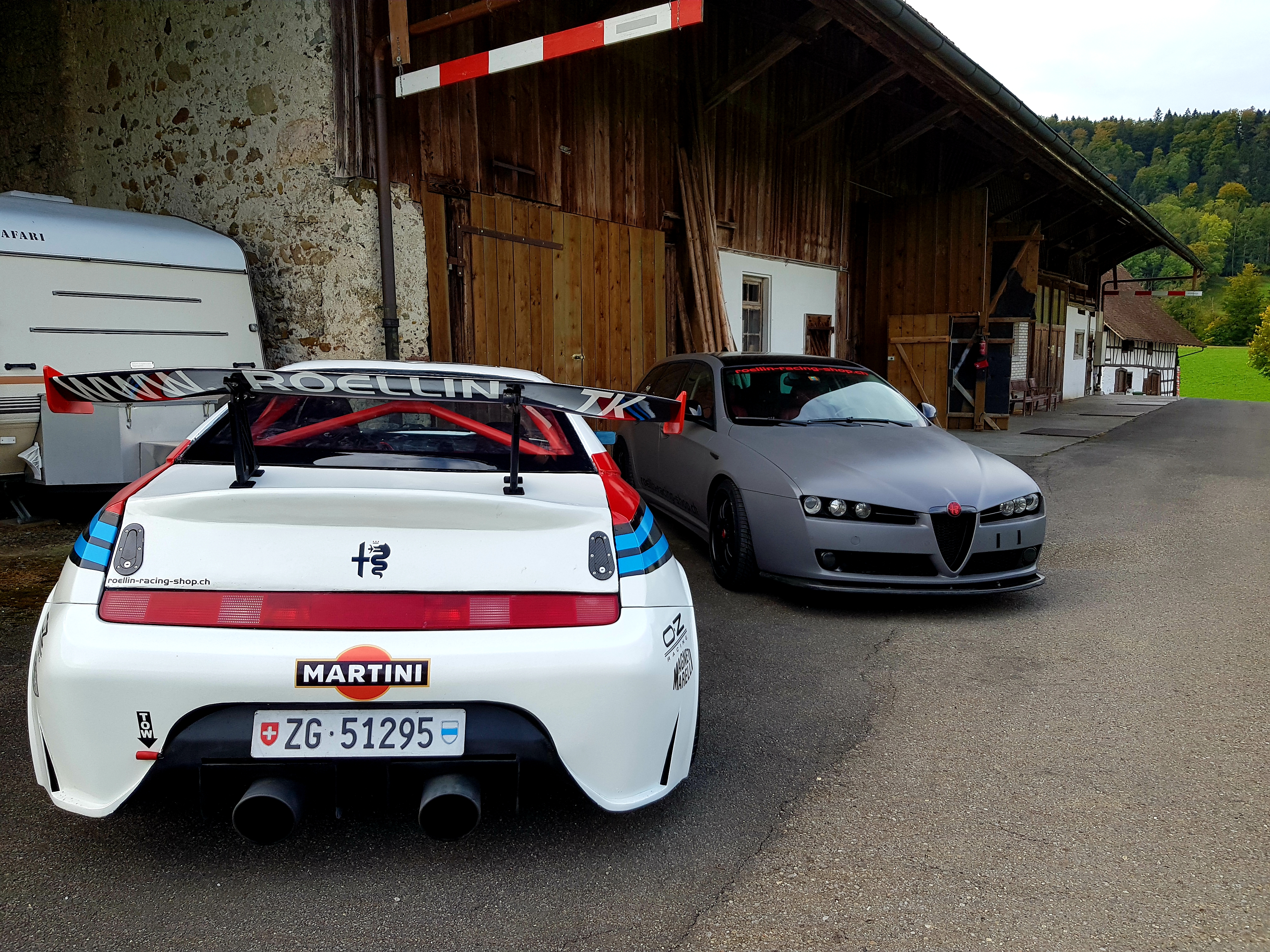

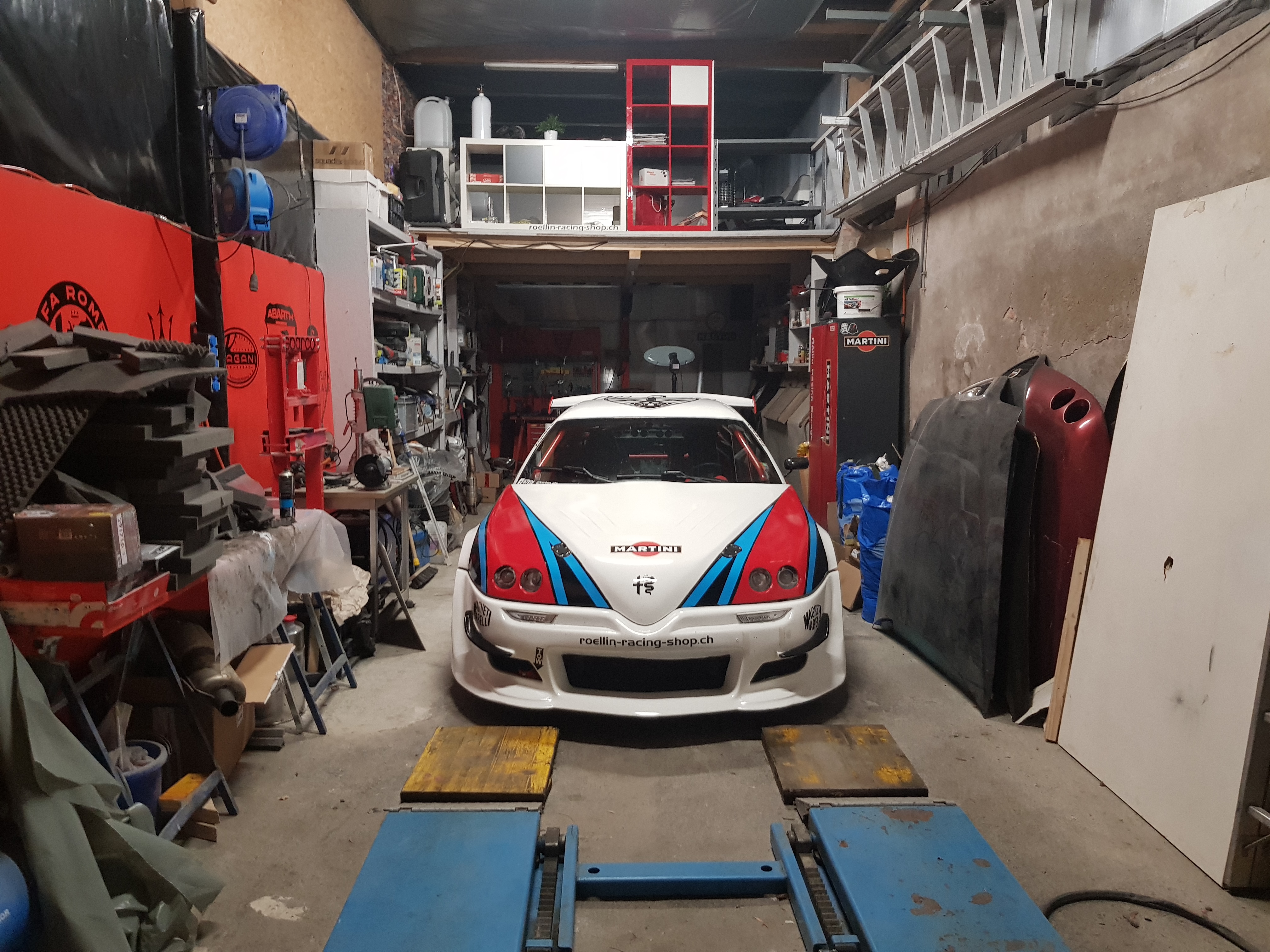

Hi all, sorry for being so rare. In middle of september I finally got it back after paying a ton of money to my garage.
I drove it alot since then :)
At the moment the beast is allready back in its cave, getting ready for the next mods :)
I was on the scale a few weeks ago. It weights more than thought :S its still 1170kg
That means I have a lot of work over winter.
some of the next mods will be KSport Uniball Bearing
Alloy fuel tank and cut out all the metall between the seats and the rear Bumper :)
Building a lot of carbon fiber parts, maybe also the floor :)
Moulding new lighter headlights
Finally mount the PU Bushings kit
Install a litium 500g battery under the dash and cut as much of the + cable as possible :)
Cut the big and haevy exhaust tips
Now I have a hydrauilic ramp, so I can finally also save weight on the bottom end of the car :)
Goal for next year is alt least 1100kg, but more likely <1000kg :)
If anyone has a good idea to save alot weight, let me Know :)

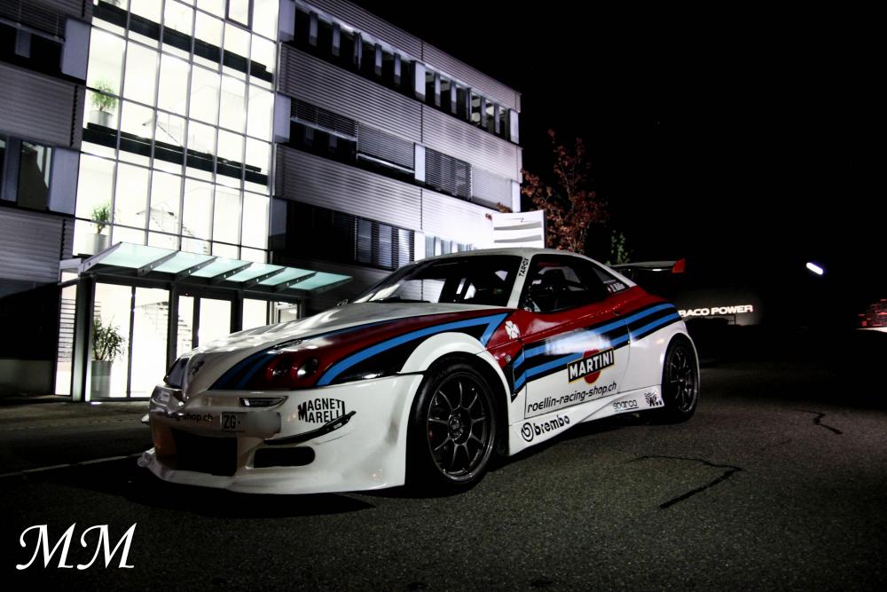

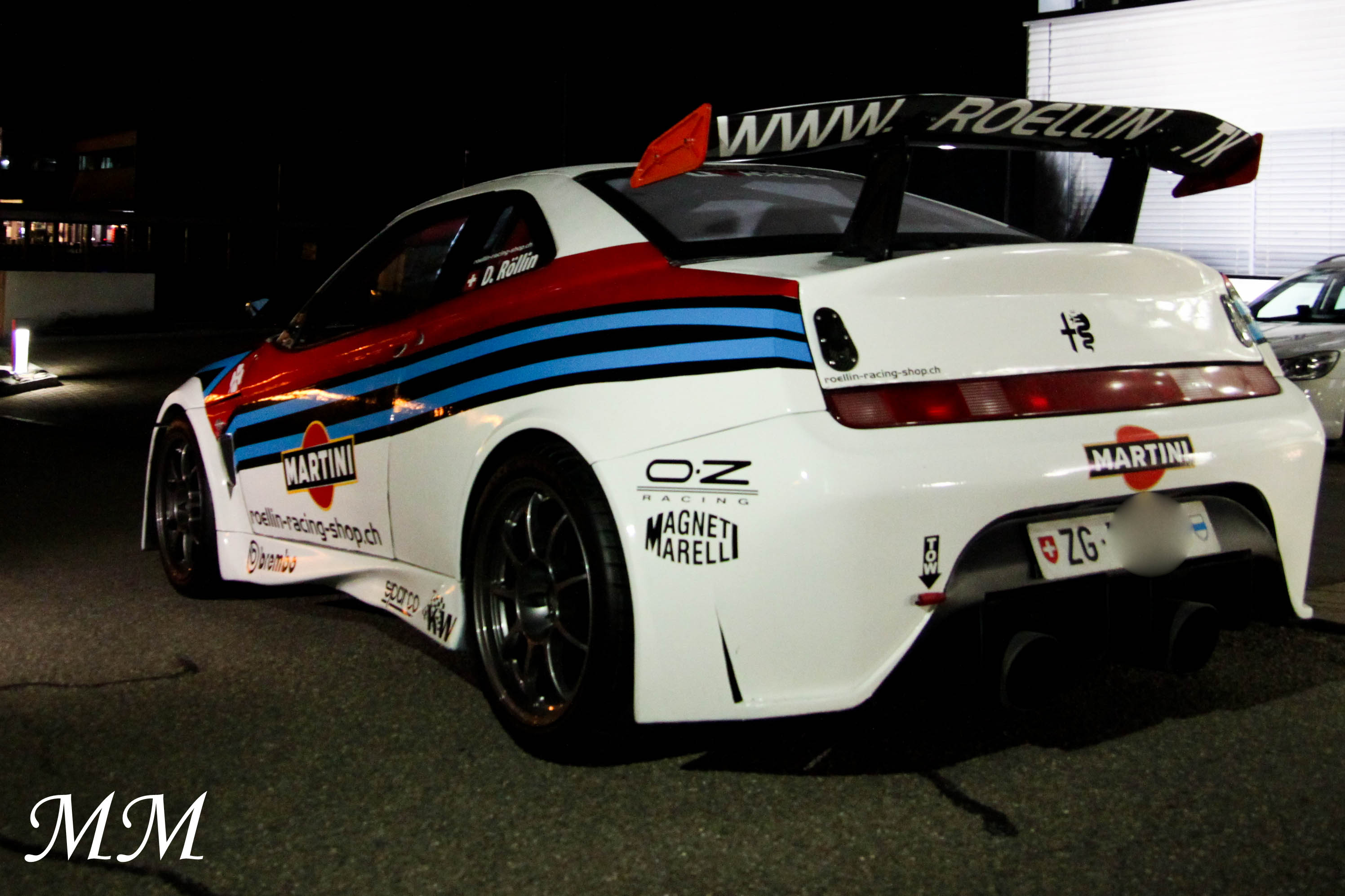

I was at all carmeetings last month to promot my carbon parts :) And I have done a photoshoot at night ( pictures will follow when I get them)
Btw. the weight difference makes such a big difference to drive it, with my 295 Michelin Pilot Sports Cup 2 I can throw it through corners as it would be straight :)

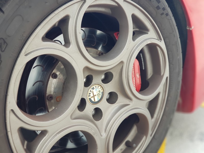

Then brakes: the standard 4 pot Brembos with 330mm discs are pretty heavy, some motorsport calipers / floating discs could help both saving weight and adding more stop power.

The same problem at the brakes, this tarox disk is the only brake disk with certificate. But I think the Calipers could be changed without problems from MOT. This is a good idea, I will check if I get lighter:)

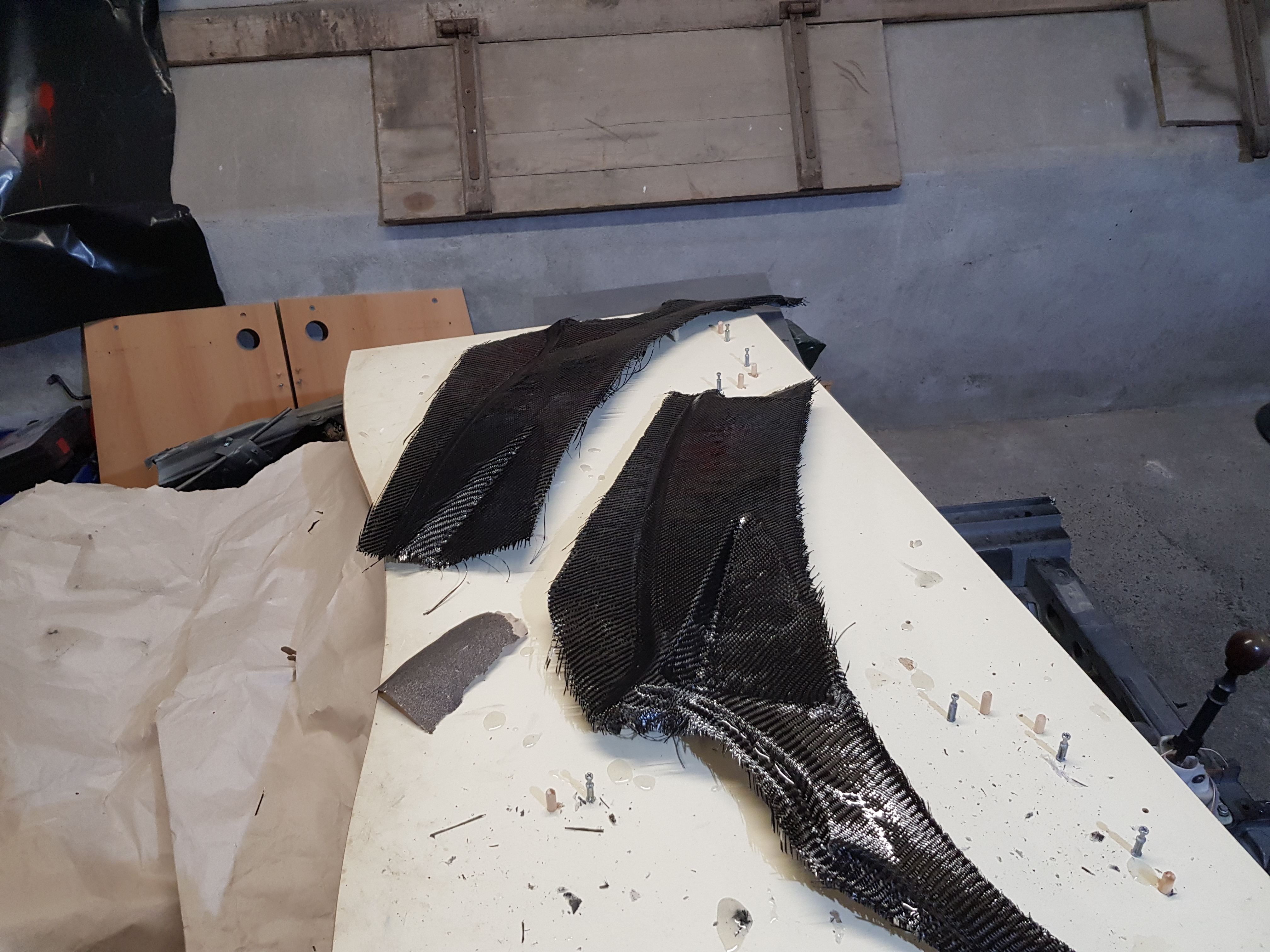

Also I made some more Carbonfiber parts :) as f.E.
Carbon fiber side covers (with polyamid screws)  this saved over a kilo ^^'
Carbon fiber windshieldwiper covers

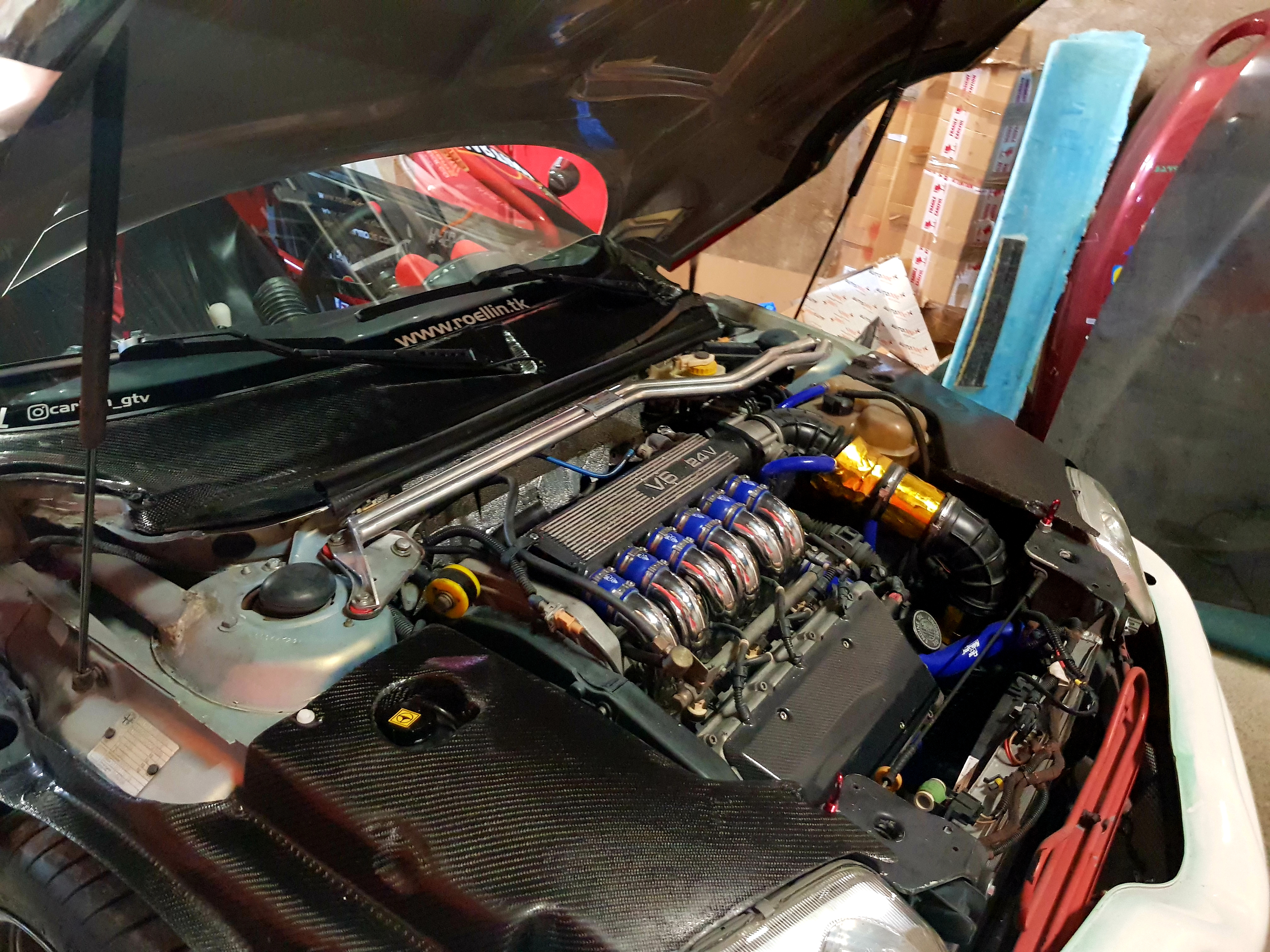

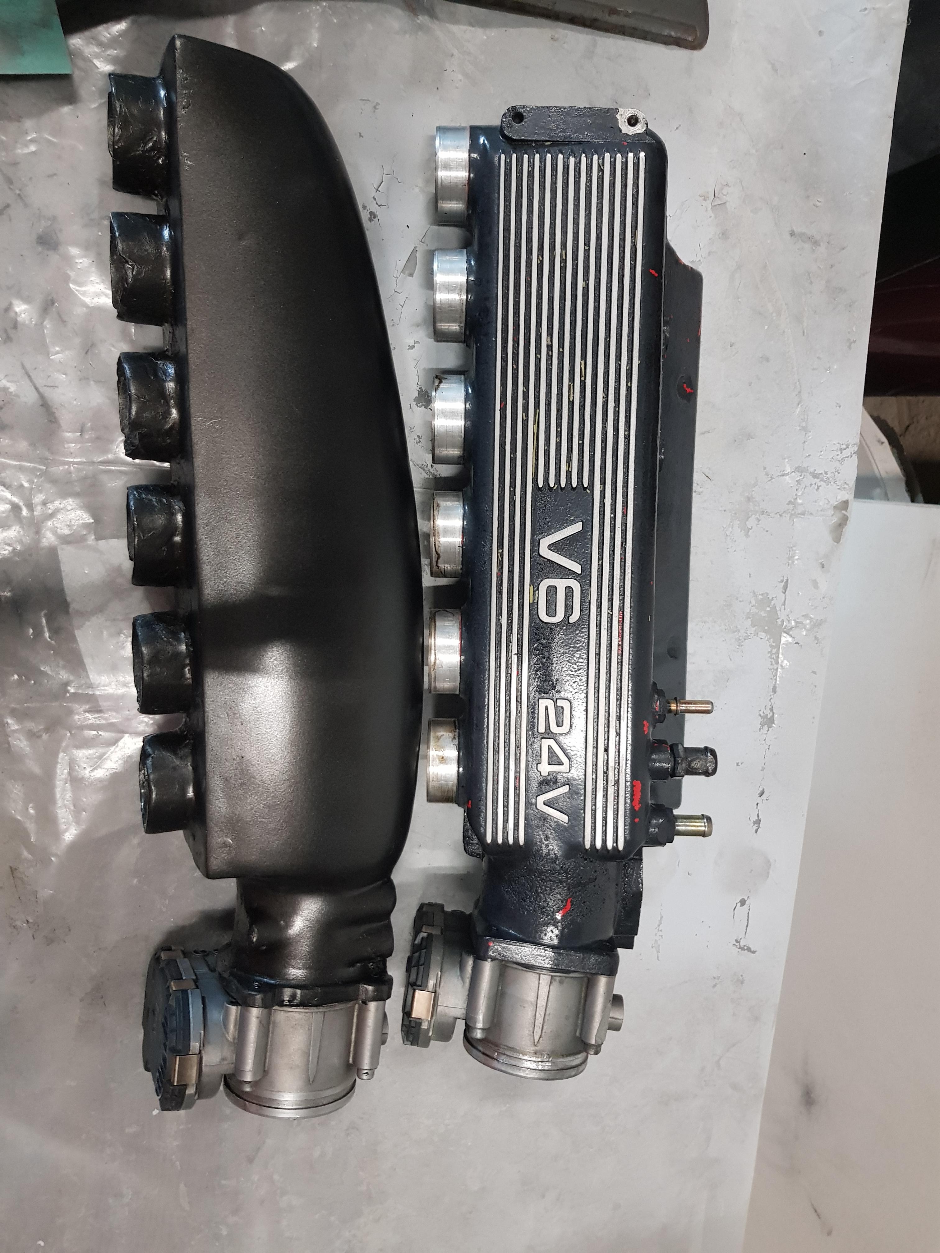

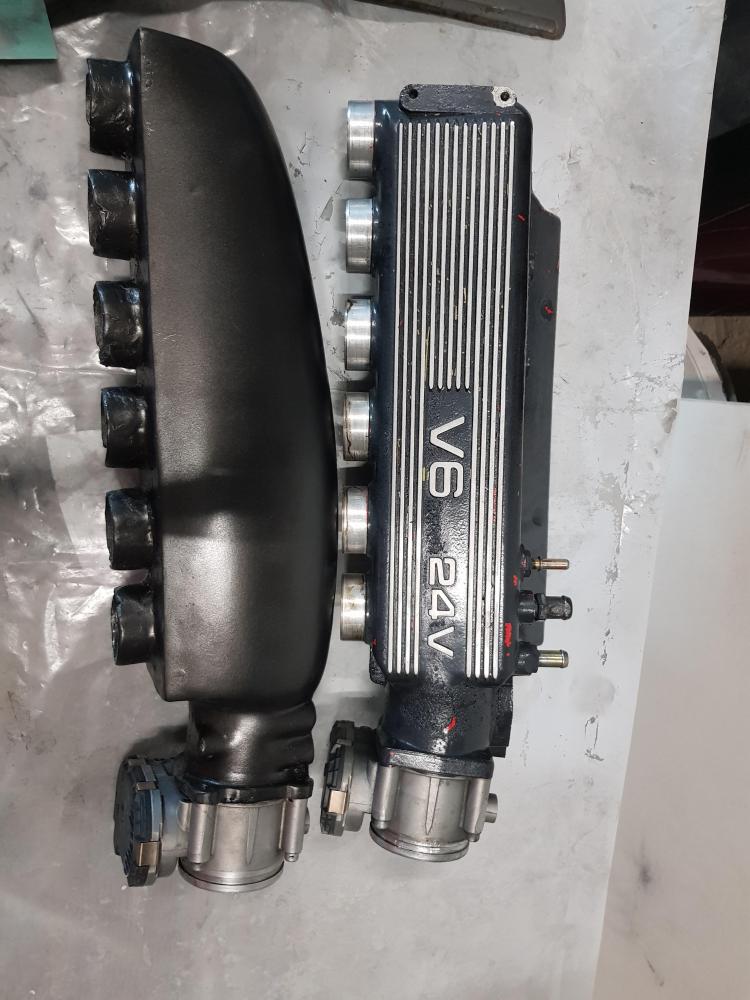

How come you didn't switch to a CF plenum yet? :)
I have bought the one from ACT, but for legal reasons I didn't mount it till yet because of the carbonfiber they easily see that its modified^^'
These ACT are to pretty to paint.
I didn't want to show it first because I need do buy more clamps first^^'
I have made a CarbonCopy :) of the ACT :)
Actually I tried to optimize the actual ACT f.E. by grinding it on the inside as smooth as it gets out of the mould on the outside :)
I also "removed" on mine the trompets, but I've formed the inside like trumpets. (I am actually not shure if the trumpets are just for easyer manufacturing or if the actually bring a benefit in there)
Further I added gold heat reflect tape on the underside :) and my Plenum is actually felt lighter than the throttlebody :)
For a first try it am very happy with the outcome, but at one little spot I grinded to much. when I throw it on for testdrive it gave a hole. I have made a pressure test with my compressor before, but it didn't work so well holding all the holes closed^^' I need to improve that next time.
I will build a new much stronger one the next days for my N/A engine.  For my turbobuild I build an insane bulletprove kevlar one :)

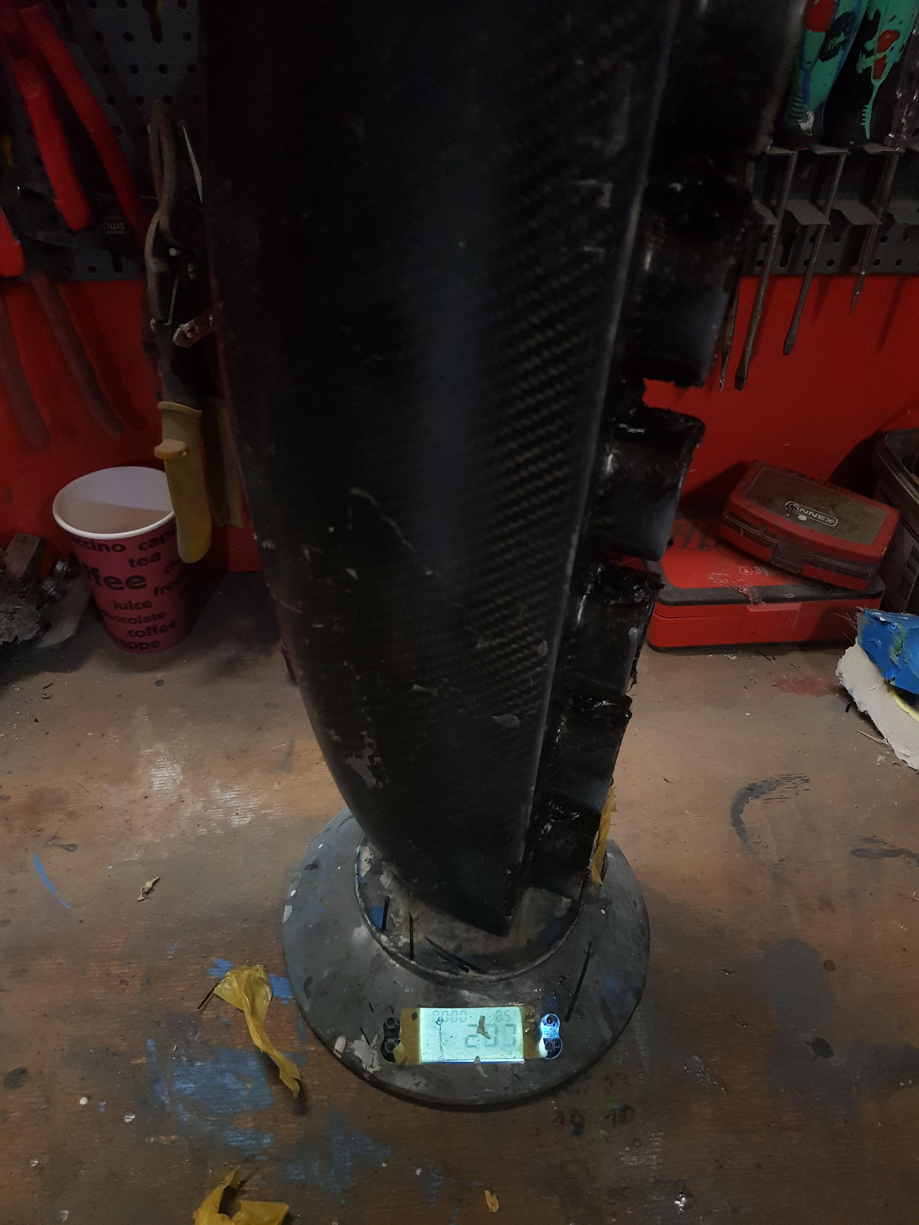

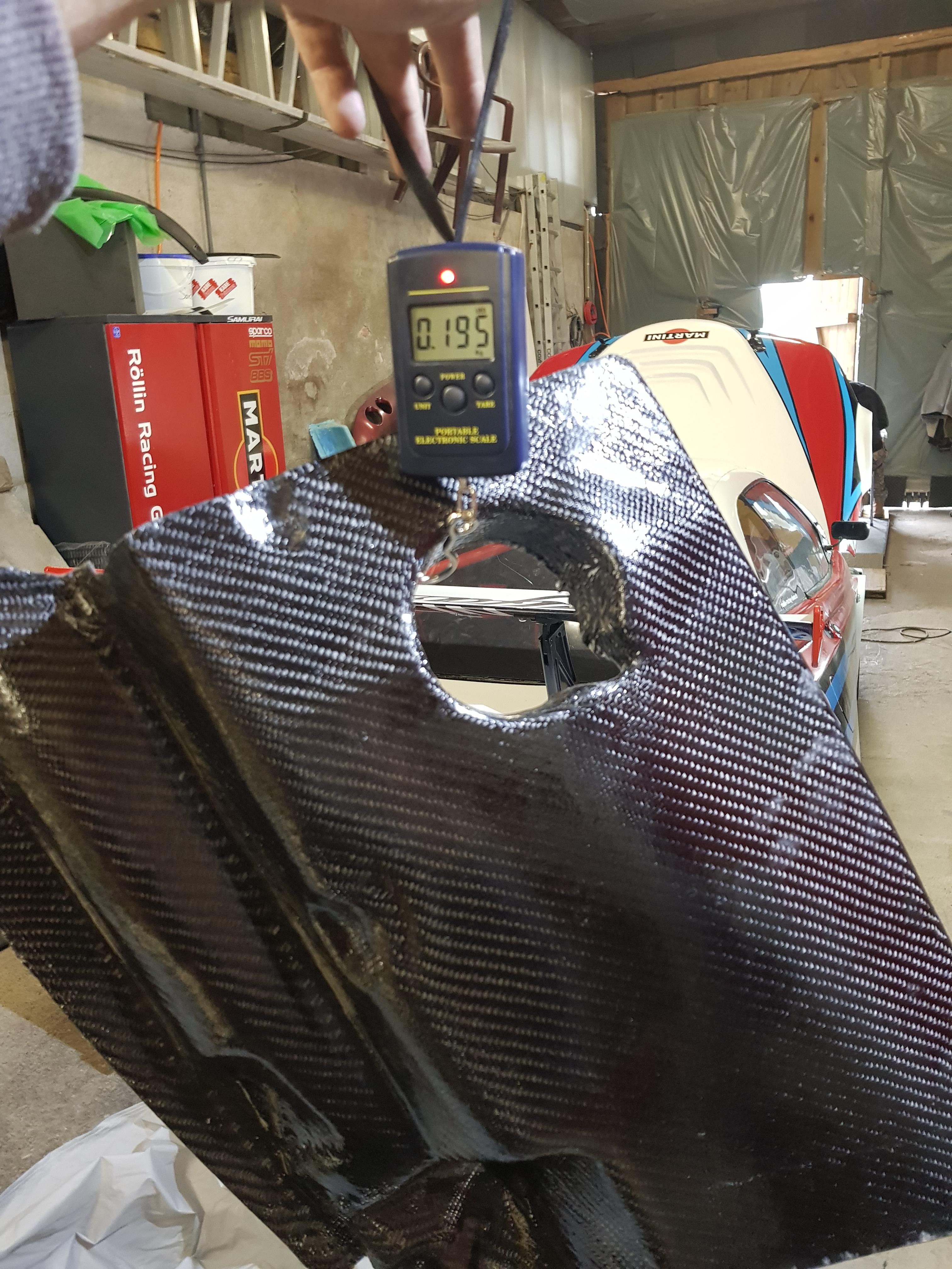

sorry for multipost, but impressive news: my carbonplenum is just 200g, saves 3kg to oem one :) (Still raw on the picture, is getting grinded now)

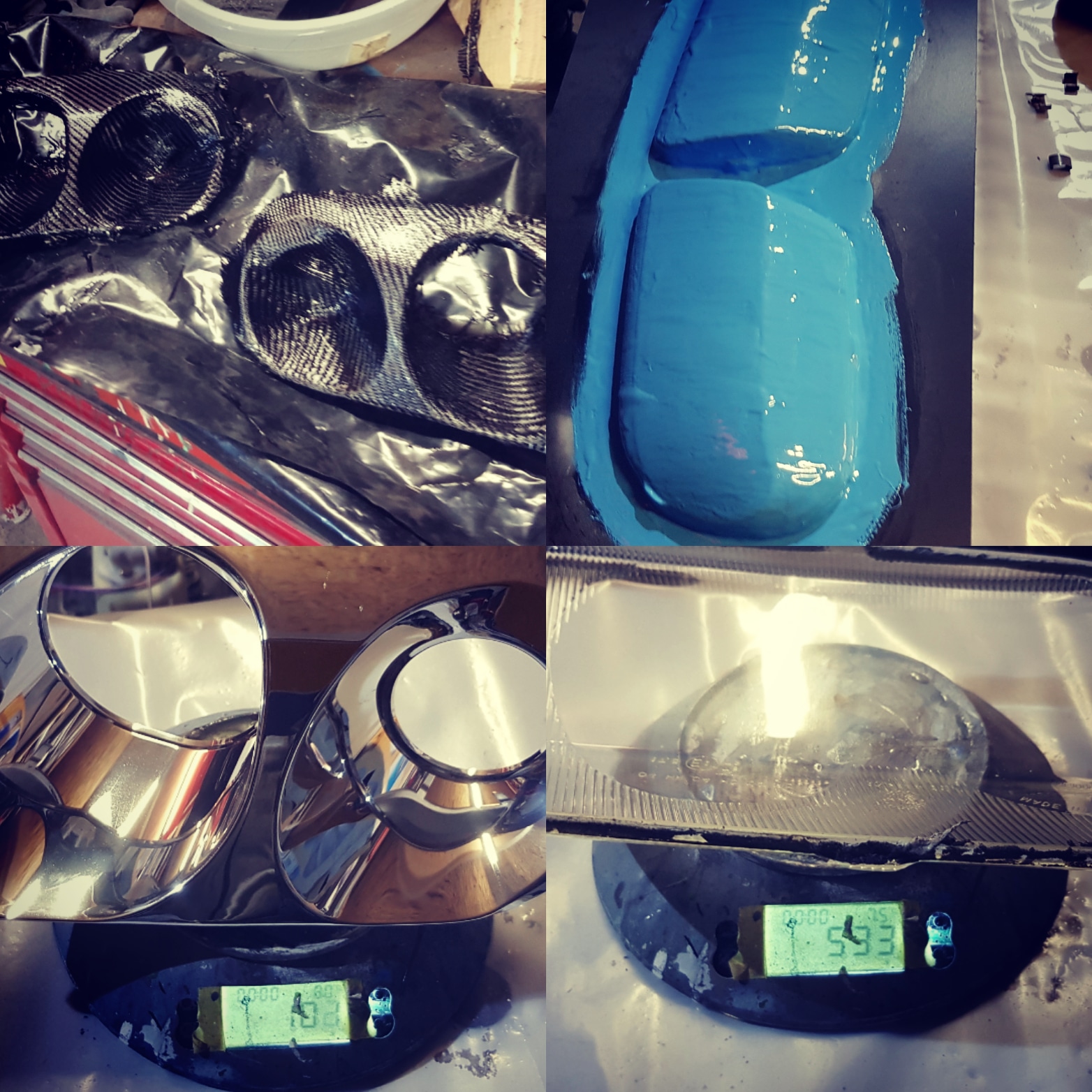

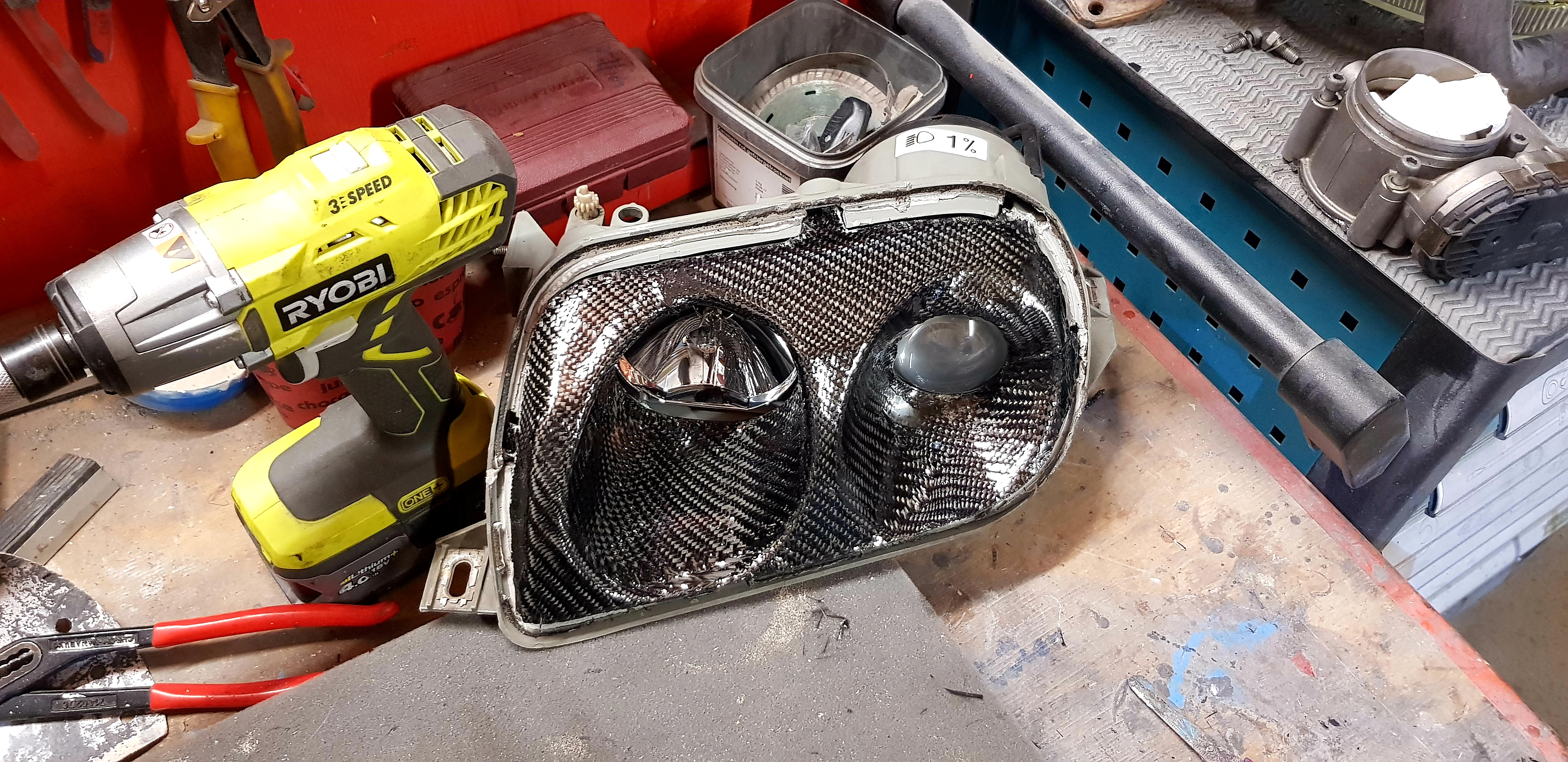

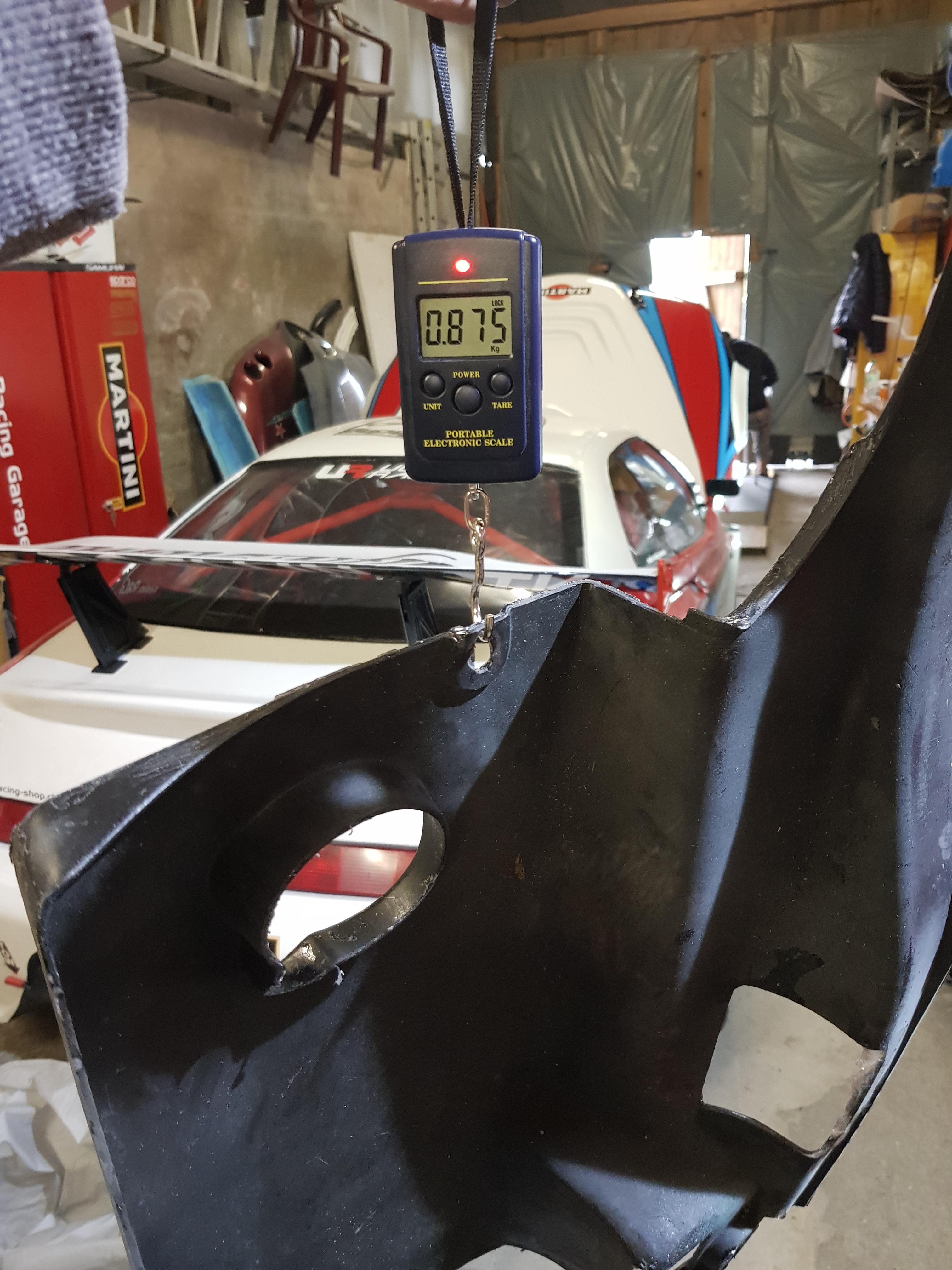

Headlight weight reduction.  Original weight 2.3kg lets see whats possible :) I am also moulding new glasses they are 530g should be possible to build with max 100g I think :)
Wow! The headlights look as if they will turn out fantastic
But none of the carbon will be visible once the hood is closed, right?

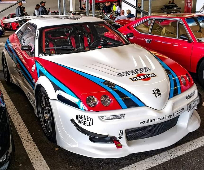

You will see the carbon when the hood is closed :) Just the blub with a little chrome and the "xenon'ish" ball will look stock. (I attached a picture)
I need to build the glass different than initially thought. I wanted to mould it with epoxy, but its too viscous, would need a ton of layers and will probably brake while unmoulding it. So next try is to do it with acryl glass. But this is ok, never done this before :)
btw. the carbon part is 50g compared to stock 101g. The glass wil be interesting :D
