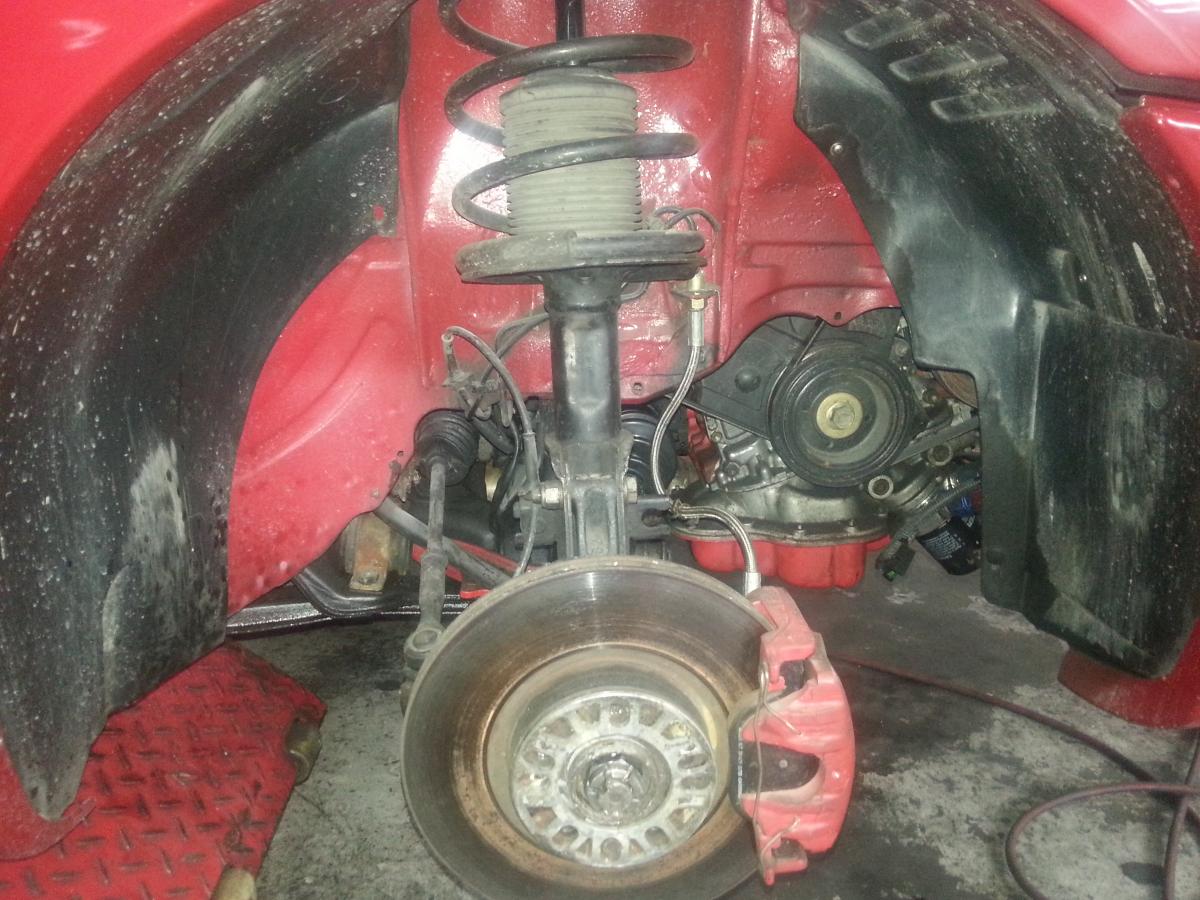

Can anybody with a V6 2.0TB send me a photo  of how their front suspension (shocks and disk brakes) looks like.

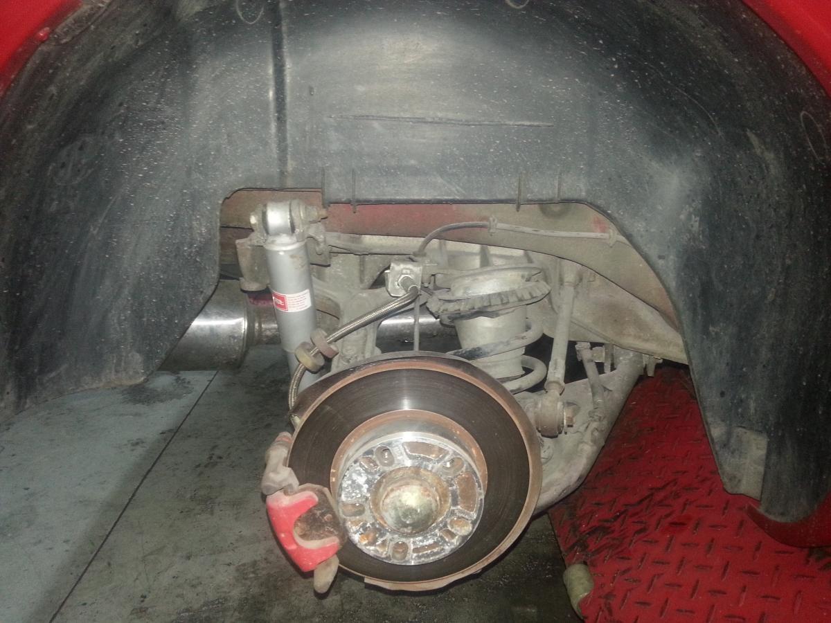

Herewith are the existing suspension on my alfa.  Notice the rear shocks has kayabas with new welded mounts.  These are things you don't do.  I am having this corrected by purchasing a rear subframe from a breaker.  Will have all joints reinforced, cleaned and painted (white, blue, red are my current choices).  When all my underchassis stuff comes in I will redo everything in one build.  :)

Explain the rear shock mount problem again, please?
Filip, The former owner was on a budget.  So what he did was  cut off the rear aluminum shock mounting points on the top and welded in the shortest possible Kayaba Shocks.  Actually it did work but the problems were that the shocks tend to hit the lower arms.
Moreso, when I rode the car ones the new mounts that they installed tore from the welded areas.  Rewelding a new or better aluminum shock mounts was an option but the problem is I may not get the angles correctly and that I was scared of the welds braking loose even if it is done properly.  With the horsepower available  for me suspension stability is a critical matter.  Nevertheless, my rear subframe arrived and I am reinforcing the mounting areas.  Will show pics when it is done.

Filip, The former owner was on a budget. He carried out some slightly sketchy repairs...

front and rear brakes look like they are OE TB stuff and the front shock absorber looks like  an OE Boge.
